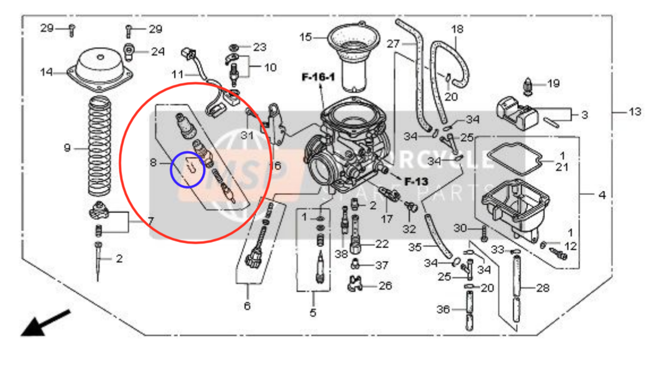

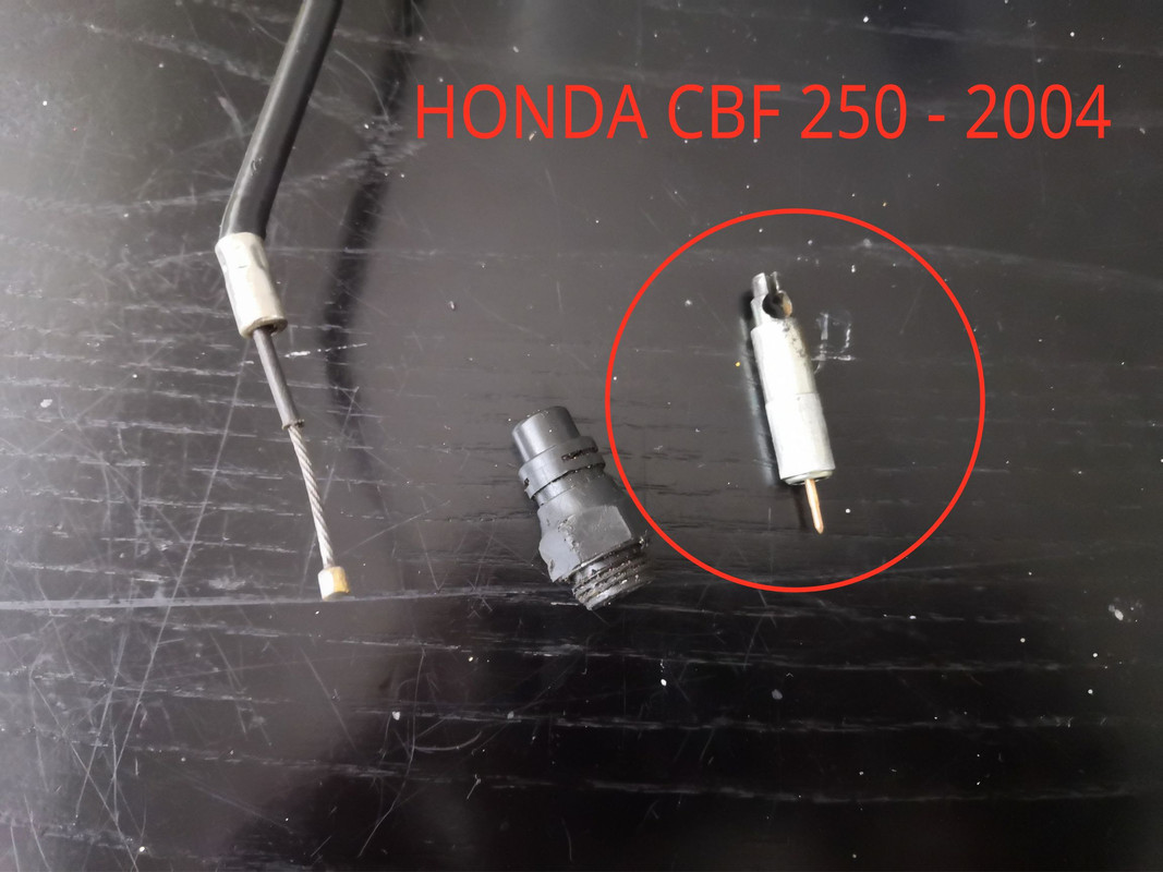

I have a Honda 250 from 2004, the choke was sticking on so I dismantled the cable and pulled out this thing from the engine or carburettor. During my destroy it myself (DIY) job I have managed to lose the spring which I guess is important but the problem lays with trying to find the part. This part was connected to the bottom. I have checked various different Honda parts websites and cannot see it on the diagrams.
I am also unsure whether I can get a similar spring or just a spring kit and try until one fits. The other issue is that this bike is rare (not desirable rare Laughing ) and finding second hand parts for it is a nightmare.
Thank You All In Advance
TL;DR : Dismantled, spring went weeeee and couldn't find again, can't find on catalogues for Honda spares, what's the part called?

That is the starter valve. Part no. 16046MBV003. The spring, needle valve and plastic fitting are all one kit and you can't buy the spring on its own. replacement parts are about £35.

Looks exactly the same as my Africa Twin chokes. Try looking on the Rugged Road website. I know they sell a metal version of the black plastic bit (they break easily as they age) they might do the springs as well.
There was a bloke on the xrv.org forum who worked out what the spring size and strength was and bought a big box of them and sold them to various members.
Excellent help, I thought I could get the little spring and clip separate (clip circled in blue) but you wouldn't believe how impossible it is. I purchased the whole set for £60 delivered from motorcycle spares eu (which is actually a company from The Netherlands), it's on back order until 26th September.
https://i.postimg.cc/vBy3mkvY/parts.png
I also purchased a new choke cable from the same place for £40, this was delivered this week and comparing them both old to new, this was the offending part.
