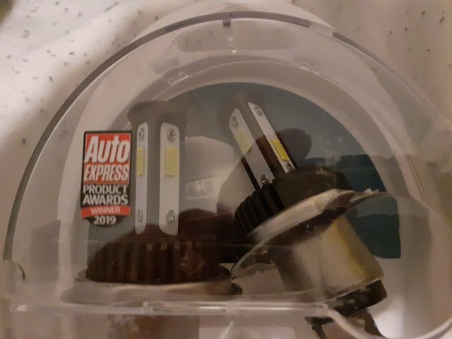

So I ordered a set of philips extreme vision bulbs from Amazon market place but what arrived (see below) does not look the picture?
The packet says H4 60/55w which is what I need, but feel these may not be?
The yellow on the bulb (persume hi/low) is also in two different locations on either bulb?
Not sure if I've snagged something that may work better than intended or if I should return. I have the Orsam nightbreakers so not bothered either way, but wanted to ask before attempting to fit?
The one on the right has also been rattling around in transit, if that means it may be damaged?

Those are LED bulbs. They could be significantly better, or worse, depending on if they are cheap shit ones or not.
Interesting.
Look to be a h4 fitting with three prongs. Turns out the yellow parts are located the same on both (removed from packet to check) so no issue there.
Clearly not what I ordered then. Not philips branded, or branded at all.
Might try out of curiosity for a ride or two.

I gather they have to have a specific reflector or they don't focus the light properly as Steve said.
Saying that, I'd be tempted to try them out of curiosity but if they aren't branded, they are probably going to be cheap sh1t that cost less than the Philips bulbs would. Can you find them if you search LED headlight bulbs?

The reflector of the lamp is a major part of the lamps focusing arrangements and if incorrectly aimed the light will not be as good as OEM.
HID suffers from the similar problems.
Mainly, the light is scattered rather than directed by the reflector and lens.
It reduces the effectiveness of the light and worse, dazzles oncoming traffic.
HID systems are so affected by anything in the beam that it is a requirement that vehicles have a lens cleaning system to remove dirt from the lens. The dirt produces a dazzling effect too.
LED bulds are superior to incandescent bulbs as they use less energy for the same lux output therefore, more light can be pushed out using the same energy.
There are replacement LEDs for incandescent lights where the LED elements are positioned to maintain designed focus.

Good quality LED bulbs will be properly focused and aligned and will give a crisper, more focused beam pattern than standard incandescants.
Cheap nasty ones will not.
The MOT guy actually commented on how clear the beam pattern on my bullet was and it has an H4 lucas reflector unit with a decent quality LED bulb. For what it's worth, my LED bulb has a moveable collar with a lock nut allowing you to rotate it relative to the three tangs which did need tweaking slightly to bring it into sharp focus. It also has a seperate electronic controller pack and was £45.

Biggest issue with fitting them to many motorbikes is actually headroom. The heat sink often fouls other parts behind the headlamp.

I'll soak in the above a bit more at another time but to update:
I contacted Amazon after posting last night (and the first response) and they issued a refund without the need to return the item.
Attempted to fit the H4 Orsam Nightbreakers (I ordered those and philips extreme to test either, and have spares) only to realise the manual is wrong and I have a H1 low beam and H4 on the high beam. Typically the old (suspected shit) H1 bulb broke during removal so I got a cheap BikeIt branded one from Halfords to replace it.
Fitted the H4 Orsam Nightbreaker on the high beam (or day-time running since I've dual headlight modified it) and the heat coming from the lamp was alarming. I'd not used since the day before, and it was the first time switching it on. I didn't really feel it would last long being constantly on (even what was in there before never got hot seconds after switching on). I may be wrong, but I er'd on the side of caution.
Fitted the LED I accidentally got sent to the high-beam and used it for the first time tonight on the return commute and by god what a difference... for the better!
The spread it provides on the road is ridiculously good and wide, and bright. I didn't get flashed (key point). The only downside is that the high beam is basically useless, or doesn't function. I found a link on Amazon of what this product looks like and the reviews for that say the same. I may try rotating it and seeing if that makes a difference, but it just emits a small amount of low additional light to the right. Its not that its aimed wrong, but rather there isn't really a switch between the two... so in a way perfect for what I want.
Providing it lasts I couldn't be happier for the moment.
I can finally see where I'm going in the dark. Very Happy

IMO....Many/most cheap LED and HID bulbs are constructed so that the point of the light source can be seen when looking into the glass lense.
Decent lamps will have a steel shield built in or a black heat resistant cap on the top of the glass to prevent this happening. If the light source is allowed to exit the light assembly without being reflected in the right direction it causes dazzle because it eminates in the wrong direction.
I have solved this issue in the past by wrapping alluminium foil around the top of the lamp so that only the lower three quarters of the light source can exit towards the reflector, and hence guaranteeing the rays exiting in the correct direction. This created a very defined cutoff point, and lasted about a year. I removed them and went back to a good quality incandescent.

That effect is not such an issue with those LED lamps as there is no light from the centre as the centre is the PCB that the LEDs are soldered into. Lights on each side of the board.
Incandescent lamps have a filament which emits light in every direction around the filament (except the ends). Thos lamps are fitted with a mask to prevent the light shining straight out (un-focussed).

I get ya, you have connected the low beam of your H4 bulb to the Low beam of the H1, so both bulbs light up at low power on low beam setting,
I thought you had connected the High beam to a daytime running light (as your post reads), as that would certainly blind people, unless that headlight is massively out of line
Are the LED ones you recieved definitely H4, or are they HB4's, in which case they would only be a single filament type bulb

H4, yes. Ones you mention have different design / plug (based on quick Google). See right hand one in first picture for the difference in placement of the yellow part for hi/low beam. Both bulbs are the same, was just reluctant to open or touch (based on possible damage) at first post.
