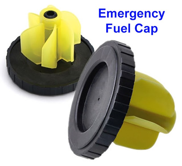

This is still a possibility and it certainly sounds like a worthy cause to the problem. The cap has a vent hole and it looks clear. If I shake the cap I can here something clicking back and forth like a valve ball or something.
When the bike did come to a halt I took the cap off hopping for a wooosh of air but nothing so although I'm not discounting this I kinda put it to the back of the list.
I've been trying to think about ways to ride with the cap off completely but use something else like a tuppaware lid and put a couple of small holes in it. That would surely sort that issue out if it is that!

these are available from most auto centres,
https://i.ebayimg.com/images/g/b-UAAOSwFMZWsOW2/s-l640.jpg
Gotta get one of them. Just the jobbie
