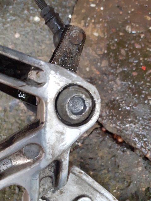

Attempted to remove the hex bolt that secures the riders foot-peg to the bracket in order to lubricate the shift lever pivot point and rounded it off, yay.
Originally the impact gun failed to remove it after a few long bursts, so I got a more powerful impact and then rounded the head (bit probably moved). Attempting to chisel a slot to hammer it round by hand also failed, as did attempting to drill it out (although I'm not smart enough for that).
I sprayed silicone grease in externally instead (as opposed to multi purpose by hand out of a tub) and left it at that. Functions as it should.
Would you replace the unit, or just spray silicone to lubricate as and when needed and live with the bodge?
Easy enough part to replace as a unit from eBay, but can't decide if I really want to throw twenty quid at it for that purpose.
Combination of factory blue Loctite (not much left), road grit and installing it with an impact last time is why it wont come out.

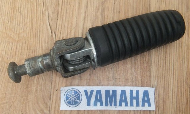

The foot-peg itself is riveted in and even if the foot-peg were removed the bolt isn't accessible from the other side (see below someone elses picture):

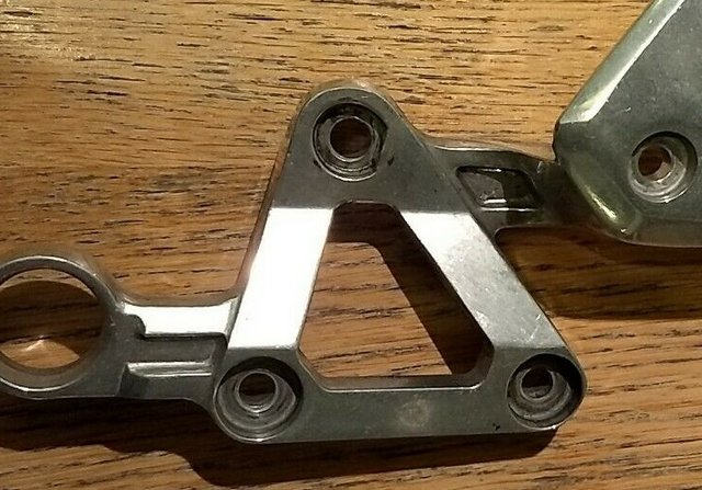

Ok. do those flats on the footpeg bracket engage with anything? If not and the bracket is free to rotate, you could put a big shifting spanner on it where that rivett is and unscrew it.

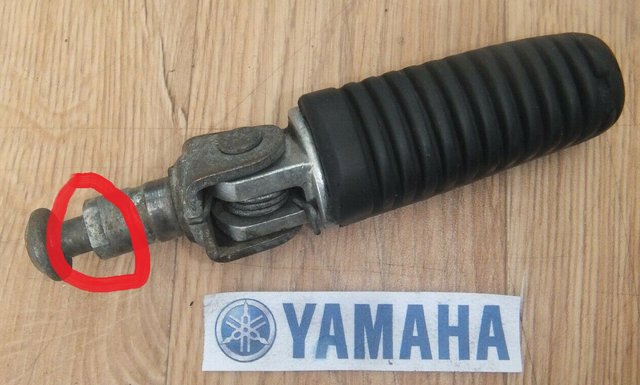

Yes, its locked into place. The part of the footpeg I have circled in red is flat (and the rest round) and has to be placed into the flat bit (top middle hole on the bottom picture) and is, I assume, therefore locked in place.
https://i.postimg.cc/hPSLRW3K/bracket2.jpg
Top middle hole in picture below is where red part circled above slots into.
https://i.postimg.cc/KvJnZqdB/bracket.jpg
As I say entire units (bracket, footpegs, linkage) can be had on ebay for £15 upwards, but I think the fact the bolt is blue loctited in is always the crux of attempting to lube the linkage (and brake pedal on other side.. perhaps their meant to be replaced and not reused).

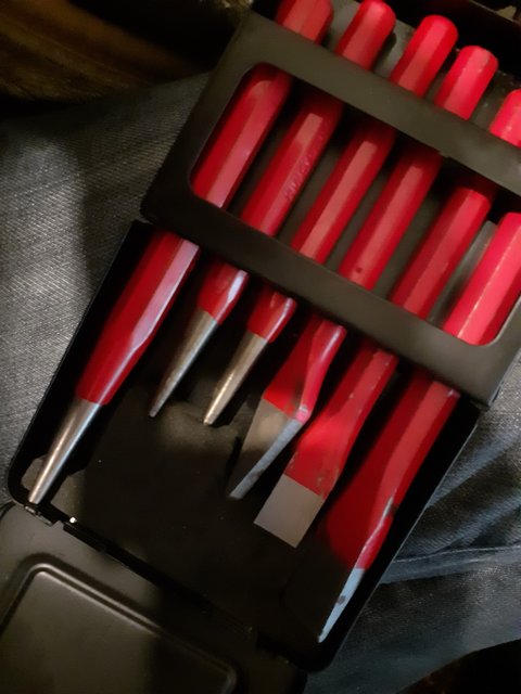

You do mean make a pilot hole with one of the below, right? As in that's the method I was trying (hence why I say i'm not smart enough at present for drilling.. lack of experience in this area Laughing ).
https://i.postimg.cc/CL1R4FQn/chisel.jpg
So make a small hole with one of those, drill deep with small bit then use large drill bit to literally destroy the large bolt head so it will detach the bracket from the foot-peg and then deal with remains of bolt in foot-peg separate?

If the diameter and depth of that semi-recessed bolt allowed I'd have at it with a Dremel grinding disc. Cut a neat slot for a flat-head screwdriver bit.
I tried a beefier version by attempting to hammer in a slot with the chisel and bang it round but had no luck. As I say I had an impact gun on it at top speed for a good few seconds and didn't have a hint of rotation. Then I got the snap-on out and it just minced it. Laughing
Drilling it may be the only way as above old blue loctite, being installed with an impact gun and road grit has it together quite tight.
