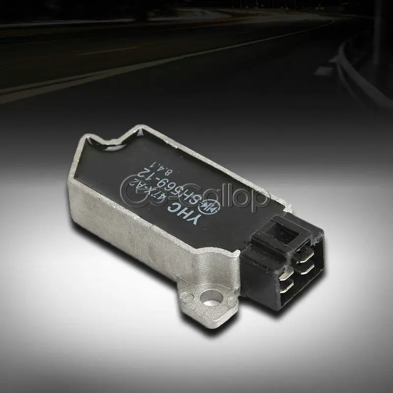

Does the bike have an original voltage rectifier (looks like image below) located under the left hand rear fairing. They tend to fail quite regularly and i suspect its most likely caused damage to either the wiring or various electrical components as the battery terminal melted!
https://ae01.alicdn.com/kf/HTB1yMg0JVXXXXXhXFXXq6xXFXXX4/Voltage-Regulator-Rectifier-For-Yamaha-FZR600-FZR500-1989-1993-1990-1991-1992-XV250-XT600-FZR250-FZX250.jpg
I would start by having a quick check over all the electrical connectors and checking for any damage or melted parts first.

It's been a long time since I heard of a regulator/rectifier failing so that it fails to regulate the voltage but still allows electricity through. Usually these days they just brick themselves.
That said, my first thought here is that the reg/rec is no longer regulating - so instead of feeding ~14V into the battery (and the rest of the bike) it's feeding ~60V. This will boil the battery and blow bulbs.
If it was running, the test would be to start the bike and get a multimeter across the battery terminals set to DV volts. It should be showing 13-15V. If it's showing move like 11V, it isn't charging and total reg/rec failure is most likely. If it's showing 20-60V, partial reg/rec failure is likely.
Alternative test is to have a look at the bulbs that aren't working. If they are all blown, it means they have seen too much voltage.
Reg/rec replacement is likely to be necessary. Hopefully it hasn't taken out anything expensive.
