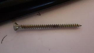

I have a stop and go without the gun, but after two punctures I've never managed to get going out without a recovery van because:
1) The first one I found after work, and was a long screw that had gone in at an angle (never did figure out if it was picked up at the end of the ride, or if it was done on purpose) causing multiple small slits. Thankfully I had a friend around in a car that had a portable tyre inflator. Without the friend I would have wasted the small canisters to no avail since it was leaking air even after plugging with a mushroom. It took a string and a mushroom to plug at home and was ridden slowly to get a new tyre fitted.
https://i.postimg.cc/ZYL4VFMw/20200114-101722.jpg
2) A van overtaking a bike in the opposite direction (forcing me to move over towards the kerb a little) either kicked up something, or I ran over something. Pop, pop.. wobble wobble.
I was on my own, and in the middle of nowhere. With no fuel stations around and two measly air canisters I decided to get recovery. The stop-and-go failed, and it was still leaking air owing to a small slit beside the plug when the recovery tried to inflate it.
I replaced that one because the bike was sold on a type of tyre that I didn't really want to take into winter, and so was the perfect time to switch over.
The recovery guy did mention glue when looking at my kit, but the mushrooms from new do come with a solution of some kind on them that may be why glue is not included in the kit (of course drying up as they get older).
I'd tend to lean towards recovery now if it occurs again. Sooner you phone the sooner you get home. Thumbs Up
