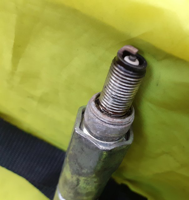

Photo of plug from problem cylinder.
I realise there are charts to compare to, but if someone could spell it out in layman's terms:

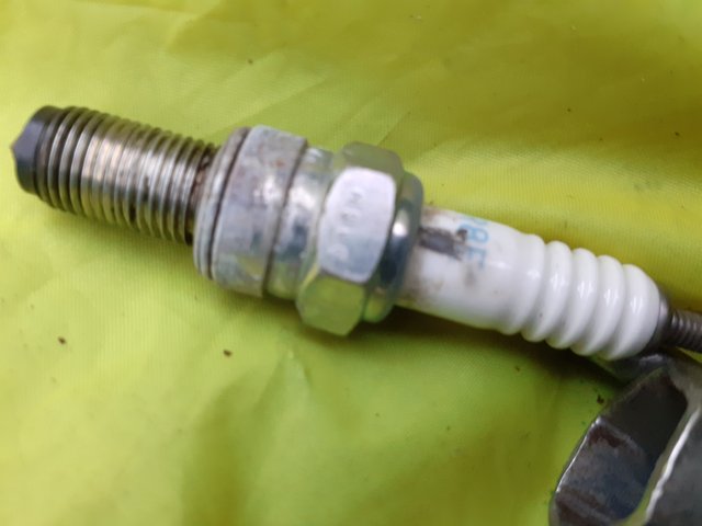

There is a mark on the ceramic part, but I've never pulled them in the months I've owned it so cannot be sure if it was there before the problem / and if this is an indicator of a problem from the HT lead / damage?

Usually wasted spark ignition would affect both to some degree or other, time to test its 'other half' (#4 ?).
/edit:
Cross-posts, I hadn't seen your photos.
If that has been tracking, a good fault. Clean it up fully and if clear ceramic below then clean the inside of the cap and re-try it.

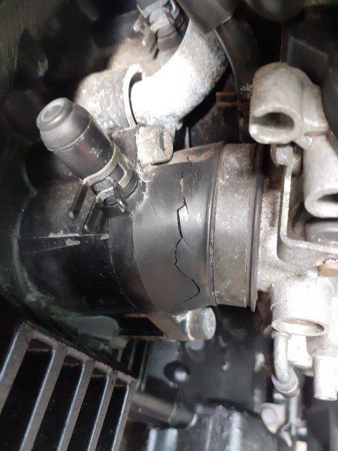

The engine to carb rubbers are badly damaged, but (IIRC) I've had this bike since August and ran them in this condition. I have sprayed carb cleaner on them to see if the idle speed rises and didn't hear a change in the engine tone or notice anything on the needle.
Fazer rubbers, so I'm led to understand, are known for cracking so given that I don't believe there is an air leak I'm reluctant to pay for them to be changed. Shop sold them like this and have had it back since so despite how bad they look if it was the cause of an issue then I'd assume it would have been obvious straight away.
I realise you could look at the below photo and say "dur, get them replaced because even if it isn't that it can't be helping," but as I say the bikes ran fine since I got it with them like that.
The bike was fine one moment, and then has got progressively worse with change to how its set up / jobs done inbetween that could have caused issue.

carb rubber looks quite bad. standard trick of wrapping with self-amalgaming tape will eliminate that possibility.

Interesting, is there anything tape and WD40 can't fix (even if only temporarily)? Laughing
