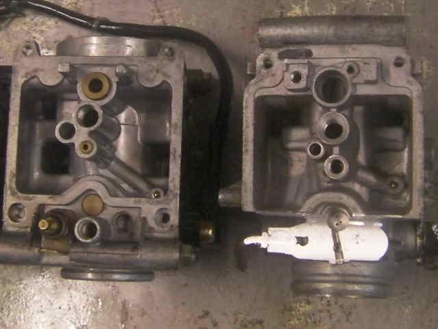

That's the air feed for the idle circuit. I tshouldn't cause the revs to hang unless the jet has fallen out in the bowl cauing the fuel to be un-metred.
Here is a quick overview of the idle circuit.
Air goes in through the air idle jet.
https://www.bikechatforums.com/files/idle1.jpg
Flows along the passage shown by the screwdriver and across the orifice of the fuel jet causing fuel to be drawn up the tube
https://www.bikechatforums.com/files/idle2.jpg
The fuel-air mixture carries on to the idle air adjuster which meters the amount of air/fuel coming through that circuit. When this is combined with whatever little is coming past the butterfly it gives you your idle mixture.
https://www.bikechatforums.com/files/idle3.jpg
And if you want to know what's under that brass plug here it is - three liitle drillings that get un-covered by the butterfly and add fuel/air in stages at low throttle openings. These are Bandit carbs and (the machined one) Fazer carbs by the way but they all work the same more or less.
https://www.bikechatforums.com/files/drillings04.jpg
So if your carb is not responding to covering that hole, chances are the air idle screw is gummed up or perhaps the low speed fuel jet has fallen out into the float bowl causing over-fuelling at idle.
