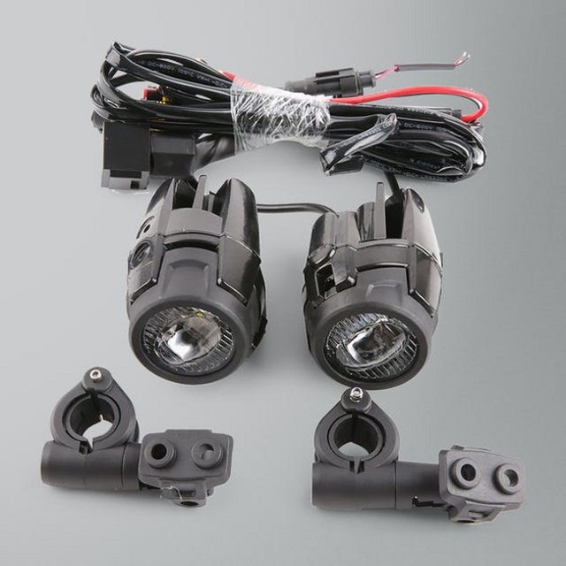

After looking more into the Denali range I came to the conclusion that their a premium brand that know how to eek every single penny out of their customers by selling much needed "extra's" as extra's instead of including them in the package deals they do (mounts, a high power wiring harness to enable dual intensity of lights etc). Their prices may be fine for BMW owners with a bike worth multiple thousands, but for a twenty year old fazer it was a bit overkill. I don't doubt their performance, but I'm not willing to spend near £300 to experience that. Laughing
I did some hunting around and managed to get some "Puig" branded ones from XL Moto for £99. I was going to wait, but I believe that's an Easter sale price that expires tonight so ended up with some protectors and the kit for less than what the kit would cost normally.
I'm aware their probably just re-branded, but Pyramid (the website) sell them too so think I found the middle ground between tat and preimum.
Probably just wire it into the accessory fuze block I have on the bike, and with some jiggery pokery and probably upgraded fixings the job should be a good'en.
famous last words. Laughing
https://i.postimg.cc/JhmPbY9Z/puig.jpg
