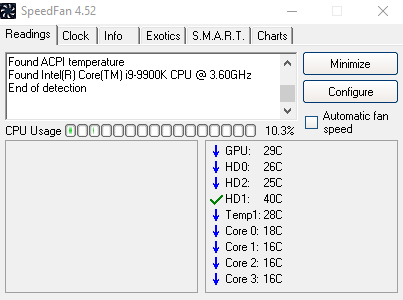

My 9900K is 18 degrees, idle on a Z390 board also, but under water.
https://www.bikechatforums.com/files/cpu_158.png

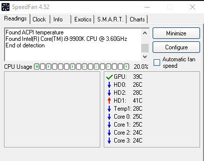

Under load (well, running Destiny 2 at max@1440p whilst streaming)
https://www.bikechatforums.com/files/cpuwarm.png
Its gonna be a cooling/airflow issue, or a fucked CPU... likely the former, make sure your BIOS max speeds the AIO if you are running one, don't let it be smart, just full send, every time.
