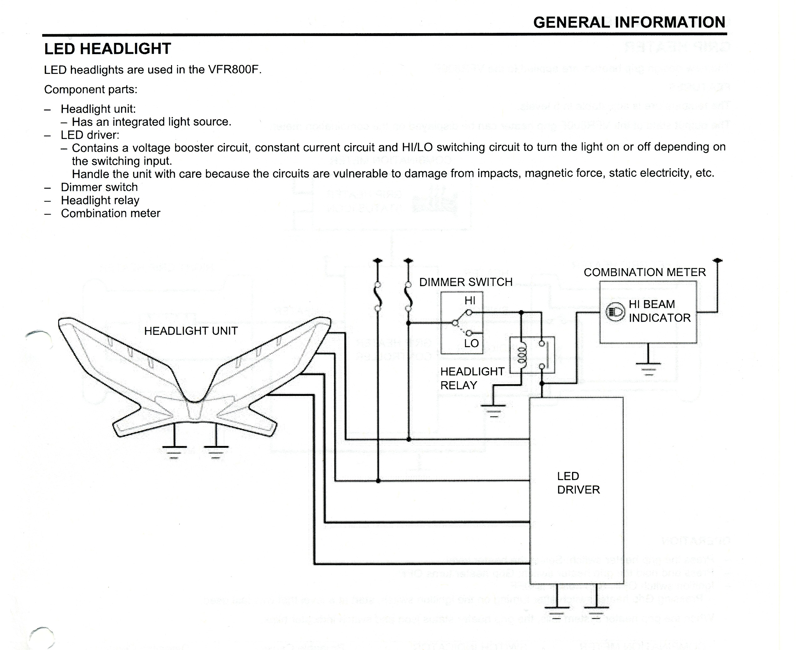

Found this, which is for the 8th gen 800F, but they have pretty much identical headlights (if not identical) - if this reveals anything?
Edit: there are four lamps, two dipped and two main beam. If I read that diagram correctly, does this suggest it's "conventionally" wired as there's an earth showing off the lamps?
https://www.vfrdiscussion.com/uploads/monthly_2016_07/VFR_Headlights001.jpg.622ed06ec2a77697ab63e5850f3010de.jpg
Agreed there's no switches on dems earths.

PostPosted: 13:17 - 26 Nov 2021    Post subject: Reply with quote
That wiring diagram doesn't make much sense. I thought the whole point of a relay was not to have all the current running through the switch.
Regardless I suspect the DataDim controller is looking for power to appear on its signal line to activate the intensity level. The opposite logic would be "signal line needs to be shorted to ground to activate." Anyhoo, should work on your setup by tying into anywhere along the hi-beam wire, between the switch and the relay would probably be optimal.
I suspect the switchgear wiring to the relay will be harder to get to than popping off the back of the headlight cover. Any reason why it's better to intercept it there rather than out of the back of headlight?
(Assuming the low beam is always on with the ignition), the switch is just tapping 12 volts off that to activate the high beam relay when you flick it to high. That's then sending a signal to the LED driver to fire up the high beam, and sending 12v to the high beam indicator. It's not a great diagram.
The main power to the light is hardwired to the light/LED driver, goes nowhere near the switch. The switch and relay is effectively a logic circuit to tell the LED driver to switch on and to turn on the high beam indicator. Relay seems surplus to requirements, I'd imagine they're using it to make sure they get a clean make/break.
Does this suggest the power to the switch might not necessarily be a clean 12v and to get that (which is what the DataDim wants) it'd be more reliable to get directly from the feed to the headlight lamp itself?

PostPosted: 16:33 - 26 Nov 2021    Post subject: Reply with quote
Assuming the above diagram is the same on your bike (fair bet, Honda like to do the same things the same way).
If you're looking for a signal to tell your lighting unit it's on high beam, I'd personally be seeing how accessible that wire between the relay and the high beam warning light/driver is. That effectively IS a high beam signal. Also if something failed, you'd only lose high beam. Fairly safe bet it's a blue wire because that's the colour Honda have used for switched high beam since the 60's.

PostPosted: 08:03 - 27 Nov 2021    Post subject: Reply with quote
BTDTGTS with an NC750x
you need to intercept the Earth going wire from the dip switch
The power from the headlight will not run a relay so
Use the earth going feed on main beam to work two relays
One feed earth back to the bike switching the headlight and the main beam indicator
The other to switch you uxorially lights
Yes itis a fiddle but not that bad

PostPosted: 15:46 - 27 Nov 2021    Post subject: Reply with quote
you might consider swapping out the high beam relay with a two-pole relay, using the additional pole to signal the "DataDim".

So managed to track down the main beam switch wire as it exits a massive connector block (buried under all the fairings - fun!). I’ve only 1-2cm of wire showing before it vanishes into a sheathed section with all the other wires plus there’s a silicone sleeve so I can’t see the Posi-tap working. Only thing I can think of is to cut it, strip it, solder in the signal wire and use heat shrink on it. Unless anything be has a better idea? It’s this one where the screwdriver is held (stinkwheel - correct it’s still blue!).
Edit: I checked this worked with the Denali lights by shoving the signal wire into the back of the block and it does! Clean 12v supply - thank you Honda for using proper switches and not PCBs.
