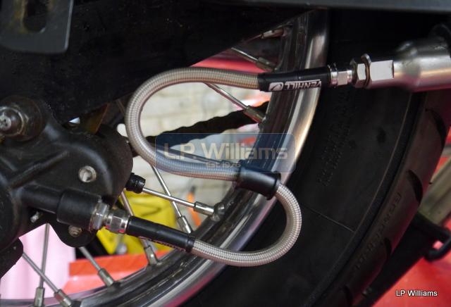

So from the master you have a little hose going to the hard line which is fixed to the caliper bracket and then the hard line snakes down to the bottom of the brake caliper.
I'm wondering why bother since I spotted this sort of arrangement:
https://www.triumph-spares.co.uk/global/media/products/large/1508919412-4566-w.jpg
What is the advantage of a hodge-podge of hard lines and flexible hoses? The front of my XSR is terrible for it...

Hard line prevents flex and expansion, I would have thought, thus increasing the efficiency of the hydraulic force being transmitted where it's needed.
I wonder why they used that S-shaped section of brake line though. Why would it be that long?
xX-Alex-Xx
Joined: 12 Sep 2019
PostPosted: 21:50 - 25 Jan 2022    Post subject: Reply with quote
For the first pic, it looks like just an easier way of getting the hose around a tight bend without kinking the lines.
For the second pic, it's a way of allowing movement in the swingarm without putting tension on the line which is fixed to the "body" of the bike.
