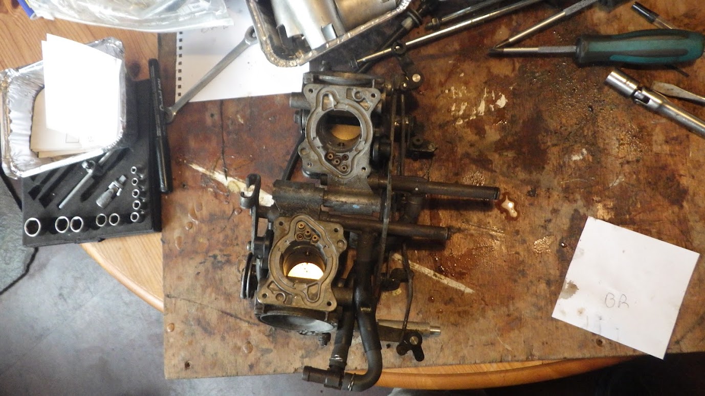

May as well start by getting everything tip-top. Carbs is a good place to start.
The 4th gen was fitted with flatslides rather than conventional carbs like the other models Drooling . I took all the jets and diaphragms out which were reasonably new because I fitted a stage 1 kit to it not too long before it was put away. The internals were actually tip-top but the whole outside was covered in black, gritty mankiness.
I took the whole bank, sprayed it with degreaser and dunked it repeatedly in a bucket of hot soapy water then rinsed it off. These pictures are AFTER washing!

I decided it still wasn't good enough so set about the slightly daunting task of splitting the bank so I could put them in my ultrasonic cleaner. This is not task for the faint-hearted! I took lots of reference photos and the Honda workshop manual has an order of operations for reassembly.

So the whole lot got ultrasonically cleaned, blown through with compressed air, carb cleaner then air again and reassembled. linkaged lubed with silicone grease and the whole lot wiped over with ACF50.
https://lh3.googleusercontent.com/pw/AM-JKLWw6BAVub-1_IrbELV8o2rj1-9yyqEbAbQIWiIrbm1Vcr6ZoJDUBfKV-IT4aiijecuJgrcHhf3Y1nPF45tlHPbLTgHJnATV4W2JNbiNErz6PJzUO2fM2mBHohjHVF8k2sTcdkuZHYFcfCqIQgECsuWH=w1378-h776-no
New rubbers and throttle cables ordered.

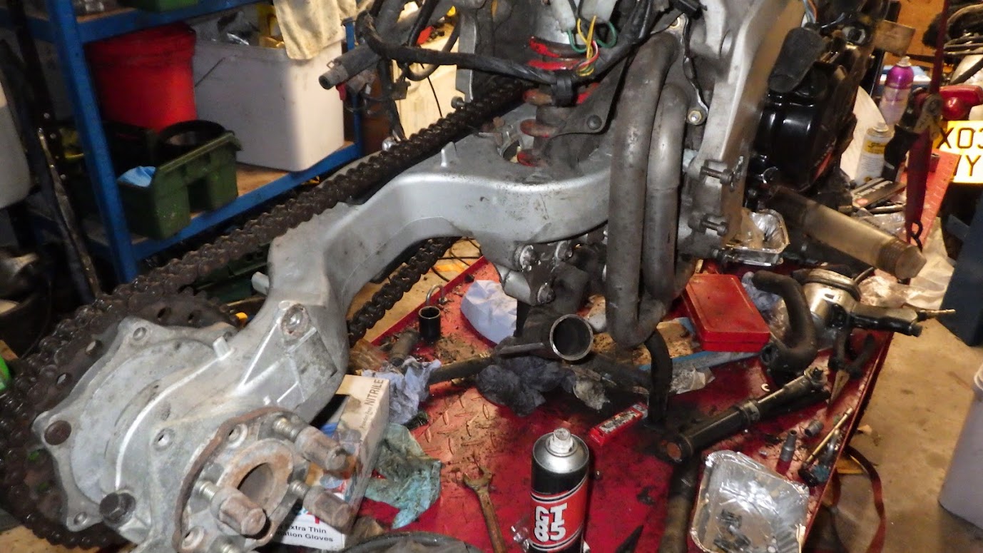

I've removed the rear subframe, peg hangers and mudguard. The subframe is sat in an electrolysis bath for the next few days. Only had to drill out one fitting. This model was peak Honda!
Remarkably the exhaust system came right off with no snapped studs (I fitted them though so lots of anti-seize compound and brass nuts were used). The system itself looks remarkably sound. It was a stainless sytem but is looking quite grotty. I've put it in a bucket of vinegar and have ordered a couple of new flanges because the ones that are fitted have cracked.
If it doesn't pan-out, I have a brand new 3rd gen motad system in a box which will fit but doesn't allow you to keep the mainstand.
I did a more intensive clean up of the space between the cylinders with paraffin, a toothbrush and lots of paper towel ready for fitting the carbs (safest thing, the there aren't open inlet ports).

Seems broadly ok. I'm going to give it all a good wipe down and maybe soak the connectors in bags of cleaner/degreaser then give them a good spray of contact cleaner and dielectric grease.
I'm trying to beware of not doing everything at once, it's too much of a task. A bit at a time and move on to the next thing.
Next job will be new plugs, fit the carbs then fit the coolant system, drain oil, filters, re-fit the exhaust and it needs the clutch doing. I can be de-rusting and repainting bracketry inbetween times. I'll leave the cycle parts and bodywork until after it's running.
The back end is SERIOUSLY manky. I'll maybe do a bit of fibreglass repair to the rear hugger too, that's a good inside job for after work one night.

Removed the caliper and disc. One of the stepped torque arm bolts is corroded beyond reasonable re-use so a new one ordered. The torque arm itself is a bit of folded mild steel. The 5th gens use a bit of solid alloy here (with different hole centres) so I've ordered a bit of alloy to make one. Also ordered new disc bolts. The calliper will need stripping and rebuilding but not today.
It doesn't look it but I actually serviced the whole rear suspension not so many miles ago so the shock and linkages came apart very easily. I then set about de-yakking the back end with paraffin and a paintbrush.
https://lh3.googleusercontent.com/pw/AM-JKLXjmvDMRBJF-OtgMBSbdDJNETzuDEPRosGs67UhQGAJbuYGImdt3fCqyFF4QShDolXaiFAQOA7FfcaQCba-79s6hv_l6PVjlMU7pwjCoq1ccvxo6EN3nrPsZDb_U9tl4UrF_dZ-UNXjpIy4dUOdkuK1=w436-h775-no
It rapidly became apparent that this was a bit of a herculean task so i dismounted the sprocket and removed the swingarm. This is surprisingly easy to do providing you have the special tools and a windy gun. I have the castle nut socket but no 14mm allen key. I improvised using one of the unitrak bolts (which has a 14mm head) with two nuts locked onto the threads. It's just undoing the distance collar for the swingarm which isn't in very tight anyway.
I'd say that's a good 70% of the yak off this bit. I'll probably re-assemble it from here and get the rest with a pressure washer.
https://lh3.googleusercontent.com/pw/AM-JKLVMHJ6jxsIs2g-bSWECW8TNuVCoOD0jHhL2JMluQ3qs58GHAw7NxZ6ivK_HvSYjlNB0PrJR0PgDgD_Vy3O7Hh2PAI7nHTPY7Yl6CoaRgQiiLBwrMUy62PD1gDZfoKbgJlXC2VwA9C5Td2SaiKETOgDL=w436-h775-no
Swingarm was much easier to clean off the bike. Inside will be good because when I had it off last I waxoyled the inside then filled it with closed cell foam so water and grit can't track along the inside and damage the stub axle bearings (which are £££!).
https://lh3.googleusercontent.com/pw/AM-JKLUqHajAAIfLEtG0FFVWBRp7ivhprd23xxgp2TlBLUwDjMWXEJIg_rd8Cq7Q4Wh04WiWi_7rimPUPGbFNHcmwXtx6xg3X8I_wYQ8S5QsZRXnKPCxSNRvKvP7lhxlu9j1vwjPhbkCU3uZnULt3WB8jxTl=w1378-h776-no
