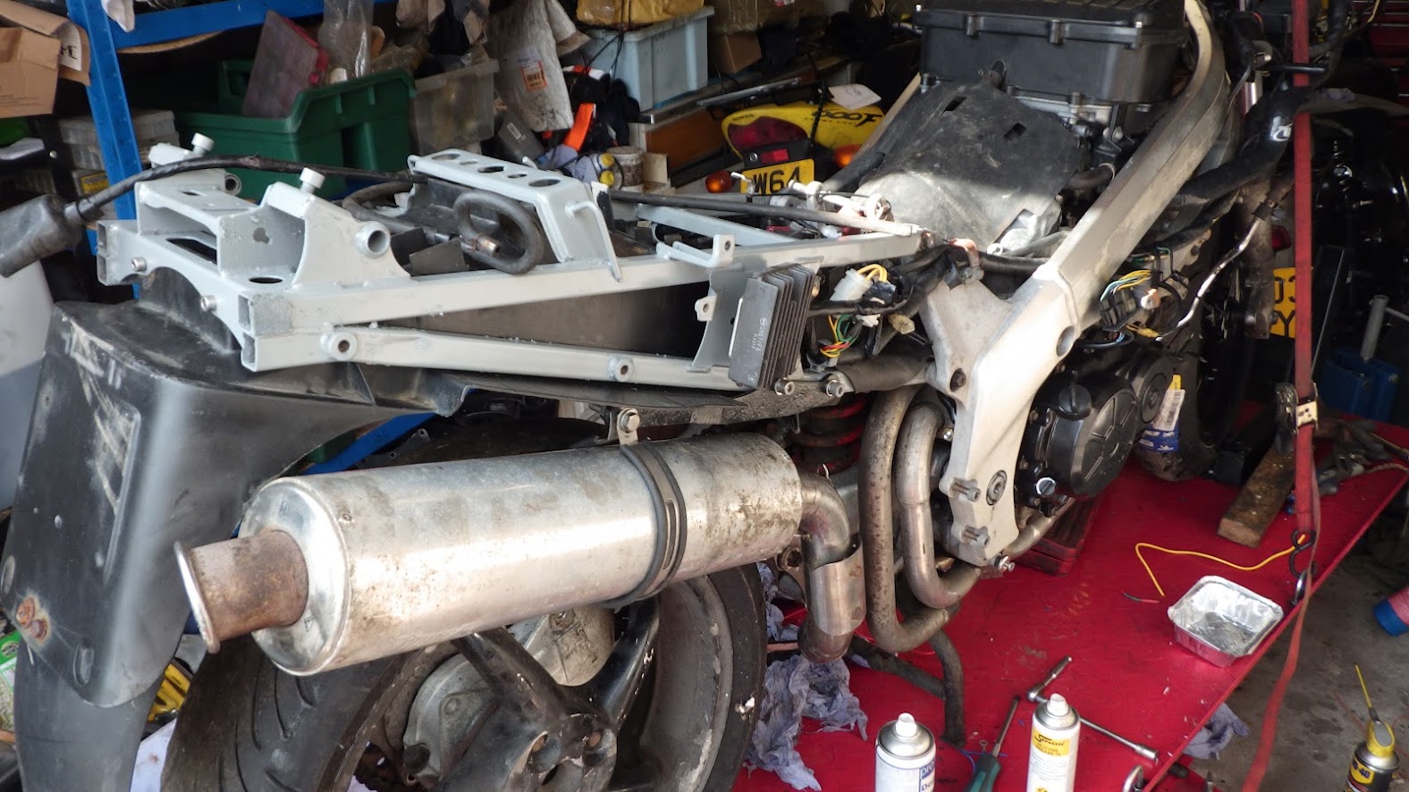

Maybe not so much with VFR ones. The frame on those bikes gets REALLY hot in town or if ridden hard, almost too hot to touch. So bolting a reg/rec to it with no cooling fins then covering it with a taipiece plastic to keep the wind off will do absolutely nothing for the heat-sinking.
my solution was to a) Use a Mosfet. b) Use one with cooling fins and c) Stand it off from the frame on an alloy plate. With an option of d) Drill some holes in the tailpiece for airflow which I did on my '91 model (the '92 model has slots there, so they obviously knew they'd done wrong)

I’m not convinced that’s the VFR’s problem. If the reg/rec is heating the frame it’s heat-sinking. Even the recommended Yamaha R1 replacements don’t have massive finning. Excessive heat is a symptom, not a cause. Fix the problem of high electrical resistance instead of trying to add more cooling to compensate.

It's the engine and proximity of a lot of exhaust in a very small space that's heating the frame. It gets very hot. Hot enough so you wouldn't leave your bare hand on it for very long. I don't think the original unfinned reg/recs stood much chance, after a good ride, the reg/rec would be sitting at about 45 degrees even if it wasn't doing anything.
