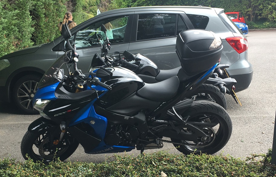

Or do what I did...
https://www.bikechatforums.com/files/topbox_205.jpg
