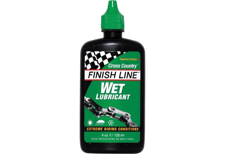

PostPosted: 13:13 - 07 Nov 2022    Post subject: Reply with quote
Use a decent bicycle wet chain lube rather than whatever miscellaneous oils you've got kicking around.
Clean the chain before adding more lube.
After applying the lube make sure you wipe all of the excess off.
ThunderGuts wrote:
This is going on my commuting bike which does about 100 miles a week irrespective of weather, so I'm lubing the chain at least once a week, more frequently when the weather is bad. I have a hang-up with bike-specific lubes as they seem overpriced for what they are.
You're doing 20 miles a day and when the weather is bad the chain needs lubing multiple times a week? Shocked Laughing That's not right. You shouldn't be needing to do that, even more so considering you're running single speed.
Get a bottle of this stuff so you can properly lubricate your chain and stop wasting your time doing a bodge job of lubing it with random oils that are inferior.
https://media.chainreactioncycles.com/is/image/ChainReactionCycles/prod1041_NC_NE_01?wid=728&hei=498

That's actually the stuff I've tried in the past (several bottles of it in fact) and the chain lasts no longer (very anecdotal but I ride enough miles to test out these things and I didn't get any more chain life out of expensive bike lubes vs chainsaw oil, in fact I seemed to get slightly better chain life with chainsaw oil!). The lube is necessary because the chain gets splashed a lot by water commuting (even with mudguards) and even dedicated wet lubes can only take so much of a pounding.
TG.
