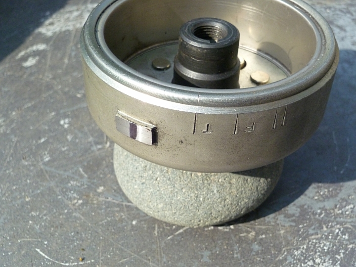

I want to modify my ignition timing.
On things like the standard Honda CMX electronic ignition and charging system you have the inner bit with the coils and the outer flywheel that spins round them.
There's a little raised lug on the outside of the flywheel. On the inside of the engine case is a sender unit bolted in place so the lug on the flywheel passes by it. That's how the fixed timing works and in bog standard form it works fine.
HOWEVER...
My modified CMX250/253FMM-ish engine abomination has a couple of mil or more shaved off the barrels/head for reasons of different piston accommodation (more poop to the pop).
This means the cam is just that little bit closer to the crank, with the cam chain slack is taken up by a manual adjuster. This means the cam is slightly rotated backwards so it opens the valves SLIGHTLY later than normal. It's not enough to hurt anything apart from the fact that it makes starting the bike by electric starter a hassle. Cold engine and electric starter doesn't play together well with the starter clutch.
I found another flywheel that was identical in every way to the standard ones I've got apart from the fact that it's ignition timing lug was positioned about 10mm behind where a standard lug is. I figured this would retard my spark slightly and make for easier starting so I tried it and it worked beautifully. Engine starts without any starter clutch clattering or occasional exhaust expulsions, so my theory was correct. But it's now slightly too retarded ignition and I want to advance it just a smidgen, somewhere between the two.
Other flywheels for both single and twin engines that use similar stators as this have longer timing lugs or they're in a slightly different place. Why? My thinking is the position of the lug on the flywheel dictates timing, as illustrated when I fitted a flywheel with a slightly clockwise lug placement and it tamed my starter shenanigans. But why are some some lugs longer than others on engines that use virtually the same alternator, CDI and sensor placement?
I know the lug passing by the sensor is what triggers the CDI, but why are some of them longer? Does it have anything to do with the CDI capacitance loading up, which would mean a longer lug would push more charge to the CDI?
I have never fully understood the reason why the ignition timing lug on the flywheel is the size it is. Does the sensor for the CDI (bolted in the engine case) do it's thing immediately as the lug begins to pass by, or is it at the point where the lug is already going away from the sender in it's rotation? Where exactly does the spark happen, and why are the lugs different lengths?
If you ground off the leading edge of a lug would it make any difference to ignition timing, or it it only at the trailing edge where the spark takes place?

the lug or tit carries the magnetic field from the rotor magnets towards the pulser coil
as it approaches the pulser coil it induces a voltage in that coil
which triggers a spark from the spark unit
This voltage rises and falls over a few milliseconds or microseconds depending on engine speed every time it passes.
the spark unit (cdi or TI) usually has a fixed voltage at which it triggers a spark in the coil.
lets say 2v for example
Programmable spark units like say an Ignitech can trigger at lower voltages 1.75V for example so in effect advance the timing without any mechanical mods or lug buggering.
If you put scope on it you could detect the fixed trigger voltage and
build a circuit to do advance it yourself.
Personally I'd leave it be unless there was to be some appreciable benefit from all that faffing about

So when I held the bog standard flywheel next to the unknown flywheel with the slightly different lugbump on it here's what I got. The difference between the two is about 8 to 10mm. The unknown flywheel's lug starts roughly about halfway along from where the standard one does (see marker line in pic).
https://i.postimg.cc/fW54yWCF/3.jpg
The lug on the flywheel (same on all Honda or clone engines of this kind, CB125T, CMX250, Jinlun JL-11 etc.) is about 17.5mm long. I'd show the oddball unknown flywheel for comparison but it's on the bike and I can't be arse to take it off, but apart from the lug position they're identical.
The unknown flywheel with an identical sized but more reversed positioned lug works better, but it's not ideal. It's slightly retarded for my liking so I want to nudge the timing forward a bit and the only way I can see to do that is to grind off about 1/4 of the leading edge of a standard "too advanced" flywheel lug.
That will shorten the overall length of the lug by a quarter. I don't know if this is going to work because I don't know when the CDI actually fires. If it fires DURING the time the lug is passing the sensor then this might work. But if it fires only as the lug is breaking away from the immediate proximity of the sensor then this won't make any different to the timing.

The waveform from the hall effect sensor is pretty much a square wave so on the assumption the CDI triggers when a certain voltage is reached, rather than any fancy jiggery-pokery with frequencies, it should spark pretty near the leading edge of the trigger.

Not sure it has a hall effect pulser, looks like yer typical
common or garden AC CDI reluctor type thing.
The wave forms I've looked at are usually a positive and negative spike each revolution which is half wave rectified to trigger the SCR.
The SCR only needs around 1.5V to fire
The source coils put out AC which is also rectified to feed the dump cap.
I'd at least put strobe on it to see how its timing before doing any butchery.
You'd get an idea of how far it is from the fixed timing mark then with a few calculations make adjustments with a better chance of success.

It's all rocket science above my head. All I know is the bump on the flywheel hakes the CDI do something, which makes the spark plug spark and makes the burny stuff in the engine go bang. So going on that theory, and the fact that I don't have a strobe, I'm just going to take an axe or a rock and knock off a quarter of the leading edge of the lump on the flywheel and see what happens. I've got like three of these flywheels so I don't care if I bugger one up.
But the mystery deepens. I have a flywheel for a Honda CB125T that looks identical in all dimensions to the Chinese ones I've been usung, but my bike would not run with the Honda one fitted. Why is that? It's got magnets in it just like the other ones. It must do the same damn thing because these flywheels are just simple devices. But the Honda one didn't seem to trigger my CDI and I can't figure that out. It's exactly the same in every way to the Chinese ones I've got but I get no spark.
Could it be something to do with the magnet polarity being different between the Honda and Chinese ones? The reason I ask such a stupid question is that my mind says that if the Honda flywheel has the opposite polarity to the other ones then MAYBE that cancels out that happens at the sensor thing because I think the sensor thing is also magnetic, or it becomes that way after use with whatever flywheel it's next to. I haven't checked the polarity between the flywheels yet but that MIGHT explain why the Honda one wouldn't fire the CDI.

After absorbing all the previous information I decided that the bump on the flywheel was probably the instigator of a square wave triggering thing, so the obvious way to retard the ignition would be to hack a bit off the leading edge of the bump.
Turns out this appears to be correct because after doing that to retard the timing a bit and subdue the shocking starter clutch malarky brought on by the consequences of my shortened top end, it all worked perfectly fine. The bike starts nice and runs well.
I still have no idea why the standard bump on a standard flywheel of this type is the length it is but I suspect it's not because of some kind of rocket science or White Man's Magic, it's probably just down to "because that's how we made it" in Hondaspeak.
So there you have it, folks. Due to the way the engine cases are designed you can't really just slot the bolt holes on the sensor and move it around very easily so the other alternative for timing adjustment is to fiddle about with the of the bump on the flywheel. Of course this is completely unnecessary on a bog standard engine that I haven't molested in unspeakable ways out of curiosity.
I suppose it's a good thing I'm not a goat farmer.
