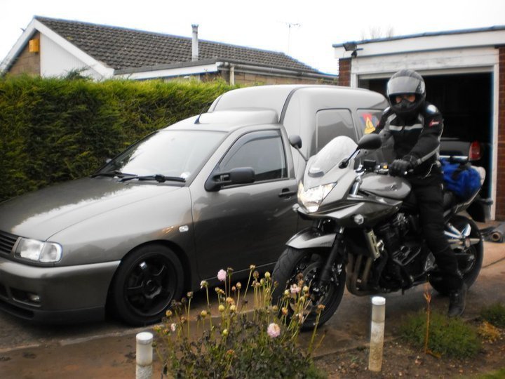

In other news, here's me on the 1250 Bandit S having no issues with it's height.
https://www.bikechatforums.com/files/76183_1615129891621_6942760_n.jpg

You did notice that my leg was angled backwards? I'm clearly not even near full stretch.
The only time I've ever struggled to get a foot on the ground or ever was concerned about my footing was on that fucking enduro thing that someone took to bbq one year.
Had no trouble with the exup or fz or the sprint I have now. The assumption you have that I'm vertically challenged is as realistic as the chances of you ever winning on countdown.
