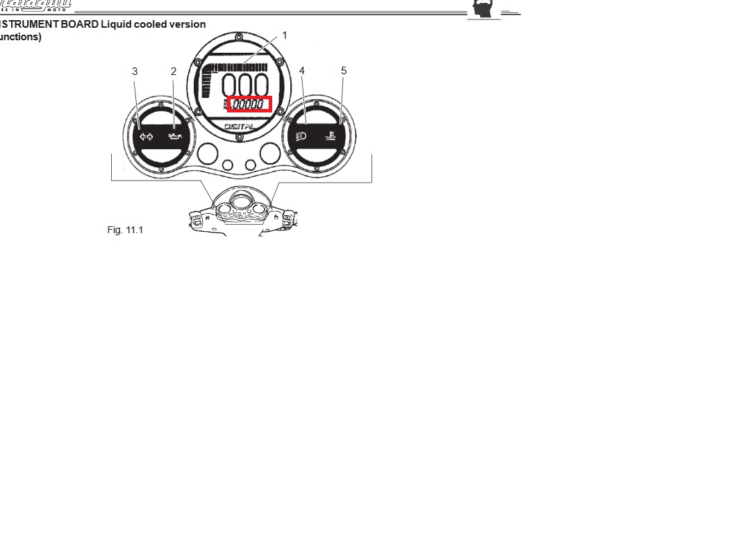

Presumably you have a liquid cooled one sold in a country where speeds are measured in kph?
You can't scroll through it to find it. They are displayed at the bottom of the display all the time.
Same as every vehicle sold anywhere in the civilised world for the road.
You also cannot swap between mph and kph.

This is your dash.
The box in red always show total km (or miles, depending on market)
https://www.bikechatforums.com/files/spacker.jpg
