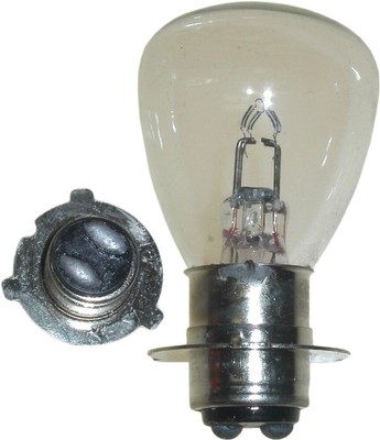

Hmm, before I get too ahead of myself I need to find a better (brighter)
lamp of the correct fitting.
The one in it looks like this odd bugger.. with the three lugs.
https://i.ebayimg.com/images/g/a7wAAOSwkydkiWhr/s-l400.jpg

Edd China actually did a demonstration on Wheeler Dealers of bulbs of different cost of the same fitting type and wattage. There higher quality bulbs out there which are brighter and provide a better beam pattern.

Well indeed..
In order of 'easiness' & cost.
1) Find a Halogen of that fitting
2) Find a LED of that fitting and rectify the lighting coil AC to DC (full wave)
3) Convert to 12V , rectify, change all bulbs and flasher unit then find a battery that will fit in the compartment etc..
Cheers
