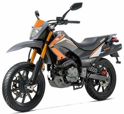

The TXM125 is a faux supermoto with fuel injection:
https://www.thebikemarket.co.uk/media/5392188/Keeway%20TX125%20orange%201.jpg?width=400&upscale=false
