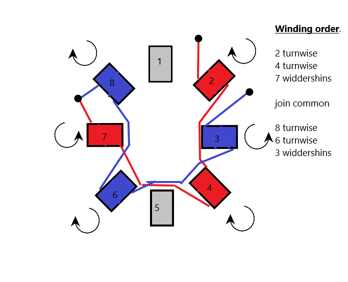

Ok, here's what I came up with. Slightly numb routing to avoid crossing the high voltage ignition coil 1 at any point.
https://www.bikechatforums.com/files/windings.png
Now, polarity/directionality. If I pick a single point of rotation with this configuration, every clockwise winding has a South magnet passing over it and every anticlockwise rotation has a North magnet passing over it at the same time. This situation reverses every 45 degrees of rotation. So that's what I want?

First set of 3 coils wound, commoned into the second and made a start on the second set of 3 coils.
https://lh3.googleusercontent.com/pw/AP1GczPYTDsSi9DNIom-a48OP8a8YatqwjzzEyV-gWSzUKB_fF51wzht__AHMRKNL6kuiZ2QL0c_y2YtD9hAxySPK5HnkeCn1MxTlPxygWSxSCncYGo1QKk560tl6Hd3FwZV4Fxn5lw8ODau0s7uwXgZmsUG=w1547-h870-s-no
Finished winding.
https://lh3.googleusercontent.com/pw/AP1GczP0ChOVRXeDFSSg3lPOSZSulunETN4gZVTtvSo6UD28ZU-D8hkj2OfE2_M3QFDOiyIYfaTVvUSbU3PvS04bRRcow0oQNHzlbhD8gJkksP11hOktqQYoR4DtOikYRQ_Cz8V7228dCImUSAvAEmNhiQGt=w1547-h870-s-no
External wiring attached, routed and sleeved. Resistance tests check out from the end of the wires so 490 ohm for the ignition coil to earth. Open circuit to earth between my two yellows and a very low resistance between the two yellows of about 0.3 ohms (at the limit of the accuracy of my meter) which is about right for roughly 15m of 1.0mm copper wire.
https://lh3.googleusercontent.com/pw/AP1GczPXIW7ax5fnOI2vAgmBX19FAKm7E7nHUvaYkOUC7eTTaKGnsuy46uqrUQPR_s0gb2lRXTbGKtKgycsZo6_w1ElX8CA9XoENjy0lr0nHqysASeKC7SSq06aDFwRV2jW8woqTMKi1bEs2qmuR8wsi5P99=w1547-h870-s-no
I'll attach it to the bike and do some tests tomorrow. Not a good time of day to be revving up a 2-stroke just now.
jeffyjeff

PostPosted: 22:07 - 27 Mar 2024    Post subject: Reply with quote
It works.
Fired right up and generates between 12and 30V AC.
With the zennor type reg/rec it lights 45W of incandescents and works the horn. That's the original Chinese reg/rec it came with and it's putting out 16v with or without a battery so that needs to go in the bin.
The mosfet reg/rec is not at all happy though. It sits at 15v at idle with either a battery or a capacitor connected but flickers and drops to 10v when you rev the engine.
I'm still not convinced this isn't ignition noise interfering with it. My digital mutimeter goes haywire when you rev the engine, even if it's not connected. I found instructions for a sparx reg/rec and they were very definate on the necessity of using a supressor cap.
I have epoxy on the coils curing just now but I'll try it again tomorrow with a resistor cap. It doesn't damage the wiring, it can cause the plug electrode to nibble away but that's not going to happen in a short run.

Just to be visual, I think this graphic is an approximate illustration of the wave form you are sending to the Mosfet regulator. Not to scale, but illustrative of the way your windings are wound and connected. Might explain the erratic reaction of the Mosfet R/R.

PostPosted: 00:36 - 28 Mar 2024    Post subject: Reply with quote
https://live.staticflickr.com/65535/53615544411_02cd4af3f8_m.jpg
You'd think it would get better at higher revs though rather than worse. It's perfect at idle, steady 15v. I'll have a fiddle anyway.

PostPosted: 20:54 - 28 Mar 2024    Post subject: Reply with quote
Consider that maybe you just don't have enough wire turns to power your charging system. Grasping at straws here, perhaps, but look at a typical 3 phase stator; it has 18 coils arranged in three groups of six. I'll wager that each of those coils has more than 40 turns wound around it.
But for the sake of illustration, suppose that each coil has 40 turns, as does your stator. That would equal 6 X 40 = 240 turns, time 3 phases, comes to 720 turns of wire on the stator. Your stator, as wired, has 240 turns split between two phases.
I'm thinking that it is a possibility that your reg/rec is working fine, and that the stator output is just not enough to support the ignition system as you rev the engine up. Higher RPMs demand more ignition pulses per second. Maybe the voltage is dropping down to 10V because the reg/rec is maxing output to the battery, and that stator output is insufficient.
Don't know why the voltage would drop as low as 10V, however. Seems that the battery would pick up the slack before voltage dropped that low.
Did you count how many turns were wound around each coil when you took it apart?
