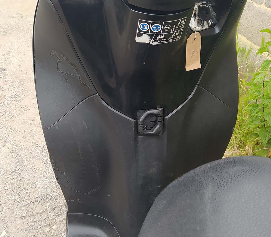

It has some panel damaged from being dropped so today I stripped them all off to give it
a jolly good degrime before getting stuck in.
I've already done the front end, that needed new wheel bearings and seals plus
new disc and pads.
I'll do the MOT work and service it then have a go at smartening it up.

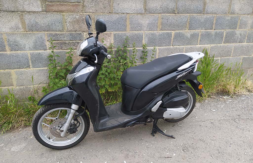

The wee scooty passed its MOT with no advisories today
so ready for a new owner to love it with much gusto and gheyness
https://i.postimg.cc/NMPC71Wc/sh2.jpg
I made no serious attempt to hide the fact its taken a few knocks
while delibbering peoples nom noms, but it doesn't look to bad IMO

that panel repair is pretty damn good considering your not trying to blend it over just make it solid again. Certainly a lot tidier than the old 'cableties as stitches' routine.
Congrats on the MOT pass.
