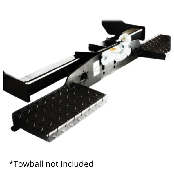

My other approach was to DIY - starting with one of the bolt on step things and build off that with an aluminium ramp (or parts thereof).
https://i.ebayimg.com/images/g/nqYAAOSwov9hiVBW/s-l600.webp
https://m.media-amazon.com/images/I/51ubTMCmZWL.jpg

If you were putting shelf up would you put the supports
close to the centre or close to each end?
Those things look like they're made more for convenience than ruggedness.

I agree its a bit counter intuitive . There are though some additional holes on the end plates of my tow bar that could be used, along with some steel bar, to bear extra load if required
