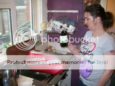

I said to him, vinger as that would eat away at the rust,as vinger eats away lots of stuff....See I have Good ideas too:P
https://i1177.photobucket.com/albums/x349/snowtigeress/104_0107.jpg
One bottle of cheap asda`s own vingar

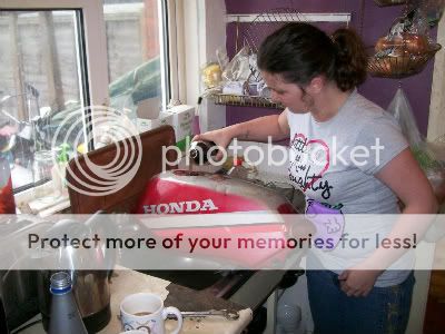

https://i1177.photobucket.com/albums/x349/snowtigeress/104_0109.jpg

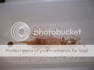

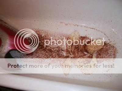

Pour the whole bottle in to the tank and shake it round and then leave it over night shaking every couple of hours
Look at all the rubbish that came out of it yuk

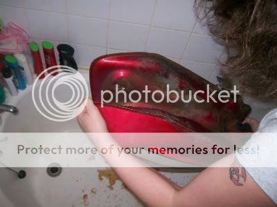

https://i1177.photobucket.com/albums/x349/snowtigeress/104_0110.jpg
https://i1177.photobucket.com/albums/x349/snowtigeress/104_0111.jpg
swill it round with water after and then leave to dry

She tipped in a 36p bottle of ASDA's own brand that was on the shelf, and shook it around a bit, left it over night, shook it around a bit more, left it a few hours longer, then rinced it out with water, and all that shit in the bottom of the bath is what came out JUST with the vinegar.
Remember, swilling with water, no more crap was coming out, so thats just what the vinegar has loosened off.
Seems to have done a pretty good job, and 25miles later, the clear inline fuel filter is still yellow, not pink! So got a thumbs up rating from me as a trick that can work!
