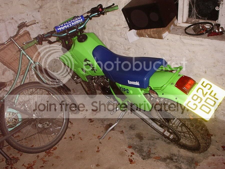

took it for a blat today oo its fun! wheelies in 1st n second topend isnt quite as good a bottom end, i rekn a bit of porting work wouldnt go amiss Mr. Green
https://img.photobucket.com/albums/v336/chester3k/P4240012.jpg

You gonna put that basket on the front of it. Wink

thanks mate some very useful stuff there,
- i dont have a rev counter so i cant see if the kips are working correctly :S. If they are old type and snapped then are they easily fixable? i was thinking maybe send the whole head with PVs attached to Stan stevens for some port work, then they could look at the PVs then,
-als i have a rs125 carb, u think that would go on? maybe i will have a look tomorrow. It alread yhas a KnN filter (hidden behind the airbox in the piccy) but not sure if its been jetted to suit..
