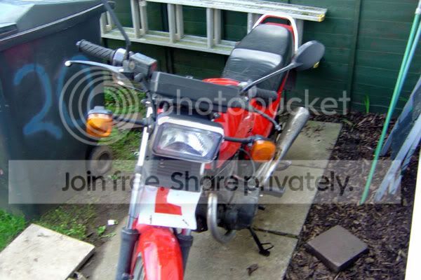

Or I could get off my arse pass my test and ride this...
https://img.photobucket.com/albums/v601/0ni/tart.jpg
Instead of this (the culprit im talking about - great bike - bad timing)
https://img.photobucket.com/albums/v601/0ni/trollup.jpg
