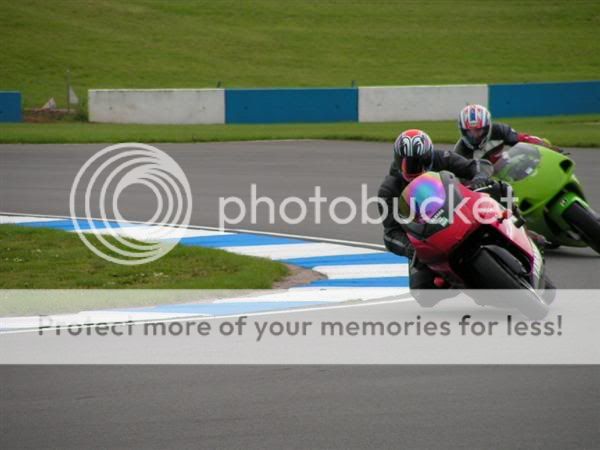

'Hanging off' does not mean you are getting the bike to lean further, in fact you can, though not always, have the bike more upright and leave more of a 'footprint' on the tarmac. More tyre on the tarmac = more grip. As mentioned above you distribute the weight so the bike will go round the corner.
One of me at Donnington GP last friday...
https://img.photobucket.com/albums/v602/strag/KDCustom.jpg
