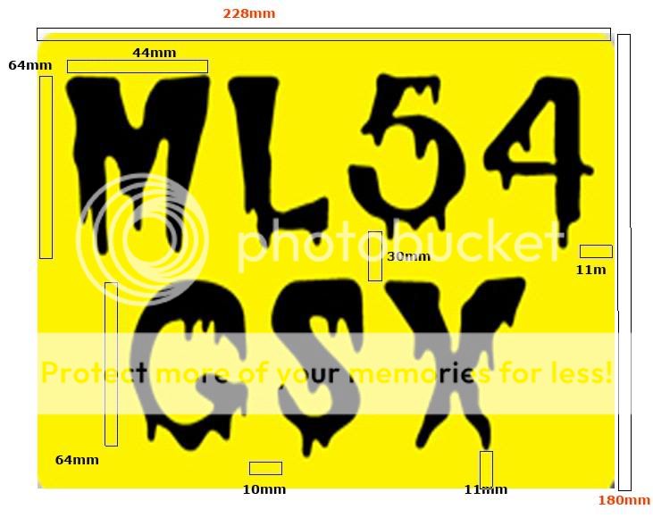

MOTORCYCLES AND TRICYCLES
All motorcycles and tricycles must display a number plate at the rear of the vehicle.
Motorcycles and tricycles registered before 1.9.2001 can display a number plate at the front of the vehicle but are not required to.
If you have a two or three wheeled motor cycle or tricycle that has a body type of a four-wheeled vehicle, you MUST display a number plate at the front and back of the vehicle.
The characters may be smaller e.g.
Character Height
64mm
Character Width
44mm
Character Stroke
10mm
Space between characters
10mm
Space between groups
30mm
Top, side & bottom margin
11mm
Space between vertical lines 13mm
Motorcycles registered on or after 1 September 2001 must display a two-line number plate number plate. Motorcycles registered prior to the 1 September 2001 may display a three-line plate, but one-line plates are illegal, irrespective of the date of registration of the motorcycle.
below is an exact sized pic of the smallest legal plate possible
https://img.photobucket.com/albums/v707/lllN30lll/untitleddddd.jpg

I got pulled and fined for a small reg. The characters where 4mm to short in height. Confused
