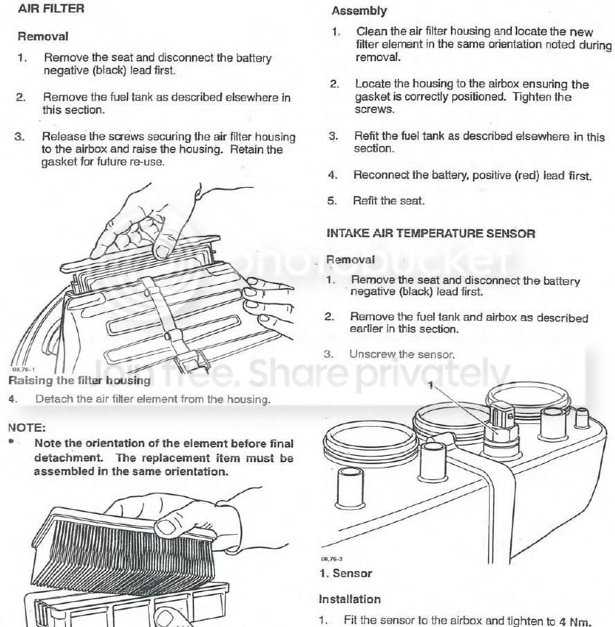

Sorry about being extremely basic here - does anyone know where the airfilter is on the Triumph TT600 - and how I check it's ok?

I havnt done it so cant guide you myself.
but here is the relevant page from the service manual.
https://i5.photobucket.com/albums/y156/colinwall/tt600airfilerremoval.jpg

Thanks very much.
I have a very annoying issue with the bike...it's seems to flutter at 3,000 RPM which is 2nd gear around roundabouts! (very uncomfortable feeling). So I'm hoping it's a clogged filter which I can resolve before taking it in to have a service.
Once again thank you.

to be honest i think your flutter may be due to the fuelling issues on tt600's so id be tempted to just hold it in first as its smoother at higher revs
