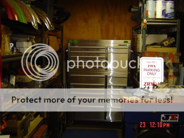

PostPosted: 02:54 - 05 Oct 2004    Post subject: Reply with quote
Ditto what Kickstart said, go with 6point sockets, 12 pointers are crap at loosening seized nuts/bolts etc.... but they are VERY good at rounding em off.
& get 1/4 & 3/8 drive, there's nothing on a bike that needs 1/2in drive & that includes axles that are torqued to 110ft/lb. If ya need a REALLY large socket (27 & 30mm usually) just buy 1/2drive versions & get a 3/8 > 1/2 adaptor.
avoid buying those bargain kits because haldf the stuff will be AF & of no use whatsoever on a bike.... unless you buy a Royal Enfield....
I could give you a list of tools to buy that would make your head spin, my *main* stuff barely fits in this:
https://img.photobucket.com/albums/v317/ZRX61/ZRXGarage/DSC00030.jpg
