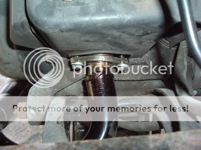

hi guys i just purchased a leo vince zx for my nrg i had it fitted by a local shop as they put the rollers in etc and a better jet.
problem is that the pipe wont line up an be flush with the case on engine the closer it gets the more it rubs on frame and it wont go flush as it catches on frame.
could this be resolved by taking the side brakets.mountings off and moving them a tad or has anyone experienced this?
Heres a pic to show you what i mean
https://i47.photobucket.com/albums/f197/ThunderTigerRacer/DSCF0707.jpg
Cheers
please reply asap as really need any idea on what to do

you need to tighten up the manifold bolts (ones on the engine end) while you get a friend to hold the exhaust, the other end of it should not be fastened up yet. When the manifold blots are tight, then tighten the rear mount. Thumbs Up
