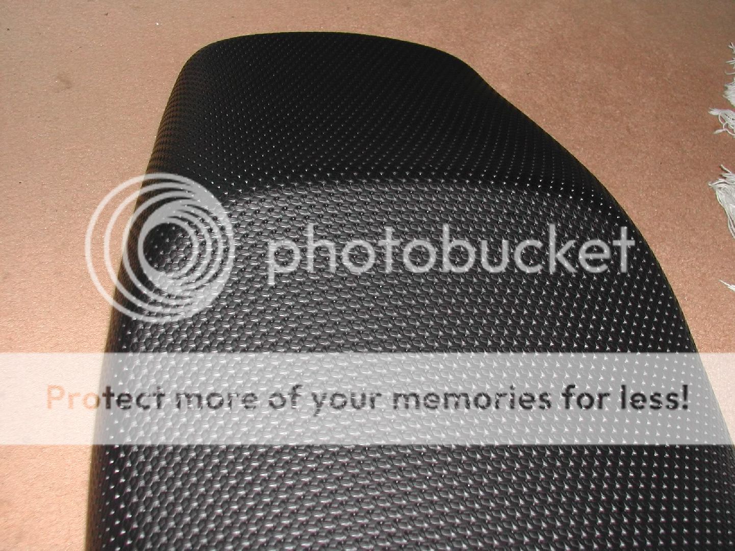

Original Seat
https://img.photobucket.com/albums/v354/andrewdelvard/DSCN0882.jpg

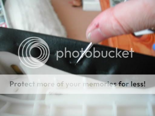

Removing the old cover was a bit daunting as I knew at this point there was no going back Confused So, before hand, I took a few digital pictures I could refer back to for reference instead of relying on my memory. I then began unpicking the old staples.
https://img.photobucket.com/albums/v354/andrewdelvard/DSCN0891.jpg

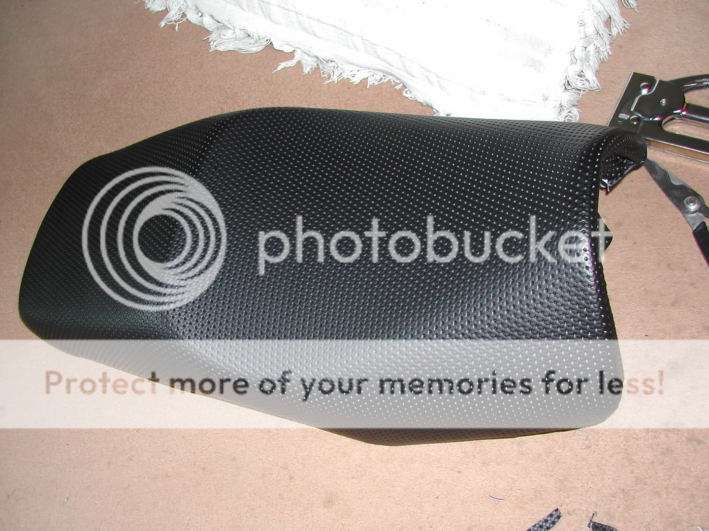

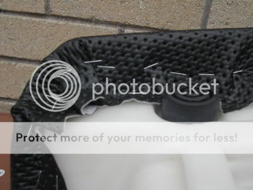

I placed the new fabric as accurately as I could over the seat to check for fit. The fabric has a good solid vertical banding so was easy to place for a straight fit on the first top seat edge. On that first edge I stapled (with a cheap £7 staple gun I'd bought of the market) the material to the reverse of the seat. Trying as much as I could, to repeat the original stapling via the pictures I'd taken. As I went round I needed to pull the fabric very taut to remove creases and make it as solid as possible. Each staple I placed was repeated on the opposite side. Consistency is the key. This took a
good hour and a bit.
https://img.photobucket.com/albums/v354/andrewdelvard/DSCN0901.jpg

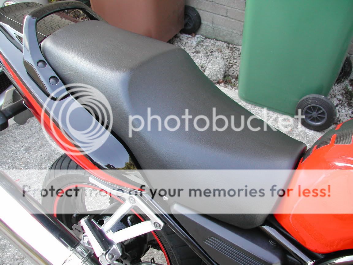

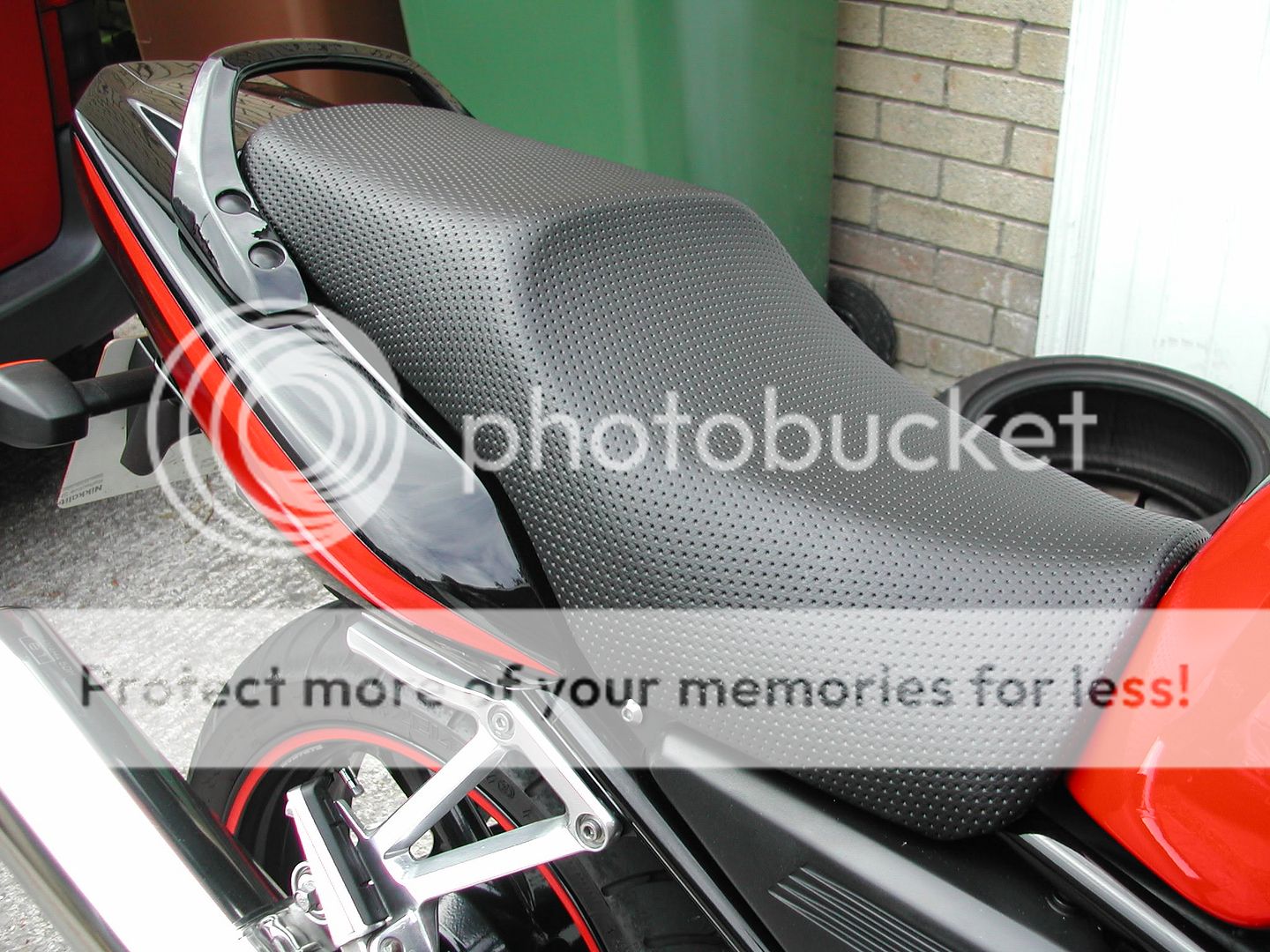

The Result
https://img.photobucket.com/albums/v354/andrewdelvard/DSCN0893.jpg
https://img.photobucket.com/albums/v354/andrewdelvard/DSCN0903.jpg

I notice there are no pics of the underside, where this very carefull stapling was going on Laughing Now thats is easy enough to do you should do suede or a fancy alligator skin next time Wink

Thanks Thumbs Up Yeah bit crap of me not to show the 'carful' stapling. I'll post an edit showing it tomorrow Thumbs Up
