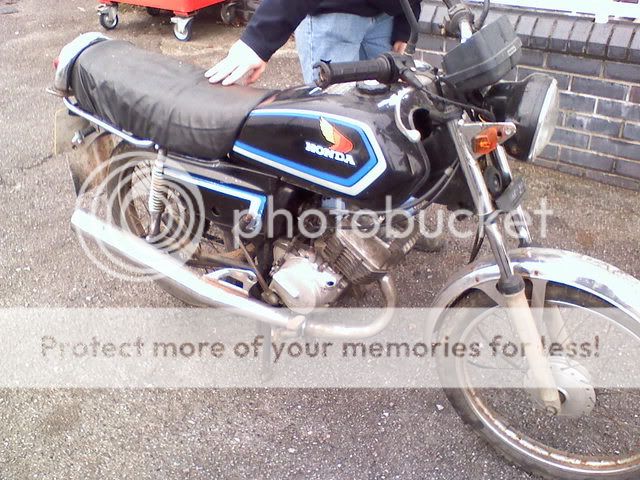

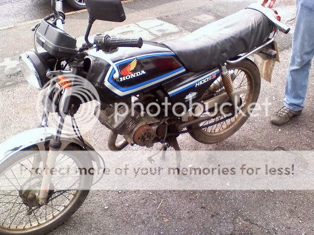

Anyway, few more minutes of vanning and we got to lay eyes on the beauty:
https://i35.photobucket.com/albums/d170/tristanthe/111807120654.jpg
https://i35.photobucket.com/albums/d170/tristanthe/111807120731.jpg
(full rundown of condition later)

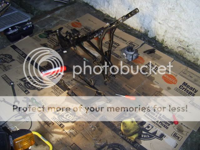

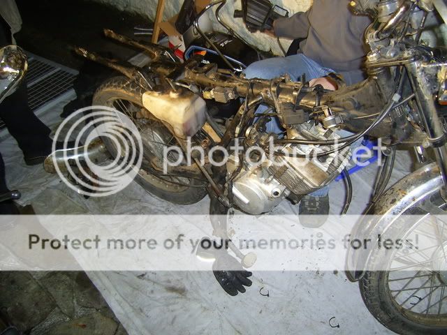

We had a few hours, so we decided to see how far down we could get her, and maybe even drop the engine.
Nothing was seized to shearing point, which was nice, though the sparky won't come out with a normal plug wrench, a bit of dubya D loving might help that though, here she is in a cheeky shot, sort of teasing us with her scantily cladness:
https://i35.photobucket.com/albums/d170/tristanthe/PIC_0018-2.jpg

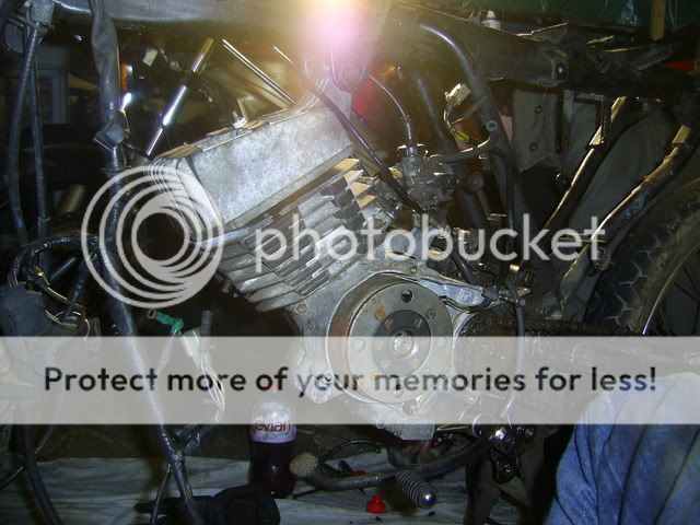

Phwoar, look at the 98cc of pure 1988 power:
https://i35.photobucket.com/albums/d170/tristanthe/PIC_0023.jpg
We had her down to her undies when she got a little bit knocked off the dodgy sidestand I mentioned, three pairs of hands reached out, mostly grabbing random unattatched bits, but she didn;t topple, we sort of looked at each other like "are we holding up a bike and barely noticing it, which led to me photo whoring an opportunity to be dead manley and lift up a motorbike rawr:
https://i35.photobucket.com/albums/d170/tristanthe/PIC_0024.jpg
Thats a war face! To be fair I had been holding it for a good minute by then because Tard on the other side of the camera got confused by the buttons, I really want to try to get her up to my head tommorow, and possibly hit someone with it.

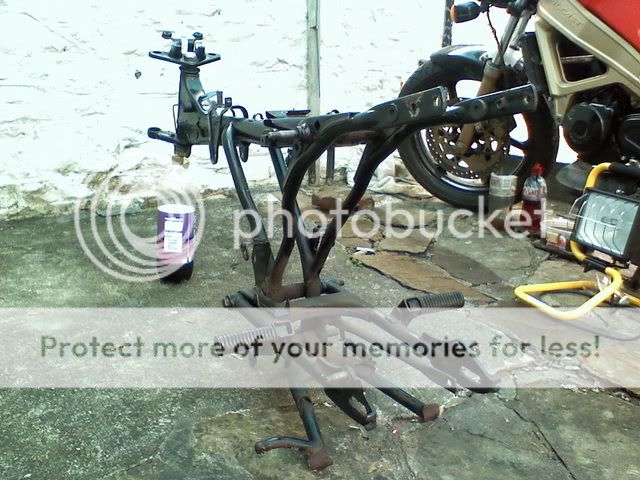

Anyway, the only things now attatched are the bars (by the throttle cable, the wheels and the engine.
And the day before, when we did our once over, plus yesterday we made a big list of loadsa stuff on the bike .and here, for our refrence as much as anything is the list:
Rear mudguard: rotten, unfixable, possible bodge with a hacksaw.
Rear light, grabrail and indis: really really new condition, which is odd. Right hand iny is snapped off.
Rear tyre: good condition, shit tread pattern, she'll be reet
Rear wheel: ine, will clean up well
Rear brake: shoes may be ok from the way they were stopping me, mechanism blatently fucked.
Swingarm: fine (well by fine I mean in relation to the rest, a clean and either hammerite or spray.
Rear shocks: seem ok, not too corroded.
Chain and sprockets: corroded, but not particularly worn by use.
Rear brake linkage: bent, may be fixable (might try to sneakily fix it on machine marts vice)
Subframe: bit of battery leak, other than that, fine
Seat: Been re-covered, badly, also it had a big spider in it.
Battery: Presumed dead, will whip the multimeter out on it later.
Loom: 'seems' alright, though obviously thats irrellevant.
Centrestand: bizzarely tall and annoying, the bike only just sits on it, a stiff breeze in the right direction will topple her easy.
Gearbox: seems fine, had dead clean oil in it.
Rear brake lever: held together with a jubille clip Mr. Green
Bottom end: other than the next three entries, nothing makes a funny noise when kicked over so it gets a thumbs uo for now.
Clutch: wont disengage.
Left had case/sprocket cover: missing.
Flywheel: very rusty, no particular resistance when turning ignoring topend compression.
Gearoil sump: missing it's cap.
Carb: seems to have fat leaking from it, will be put aside for a bit probably.
top end: seems to be some compression, may be able to get away with just rings, though we're prepared for the worst, it int seized or come apart (so we wont need to break out the sandpaper Razz )
Zorst: seems alright, was held on by two bolts at the head Shocked .
Mainframe: it has a mainframe? oh right, that bar under the tank, fine (as in the corrosion we expexted.)
Tank: couple of fairly big knocs, little bit of rust at the front. Key doesn;t fit and the locks been screwdrivered at some point.
Steering bearings: seem fine.
Bars and switchgear: Look very new.
Clocks: 33000 miles, Locks been screwdrivered at some point.
Lights: no battery to test, slight bit of electrical tape holding headlamp together.
Forks and seals: no pitting, seals are good, held up to dozens of curbs and stairs.
Front tyre: good bar the patter.
Fron wheel: again, will clean up nice.
Front brakes: probably just shoes gone.

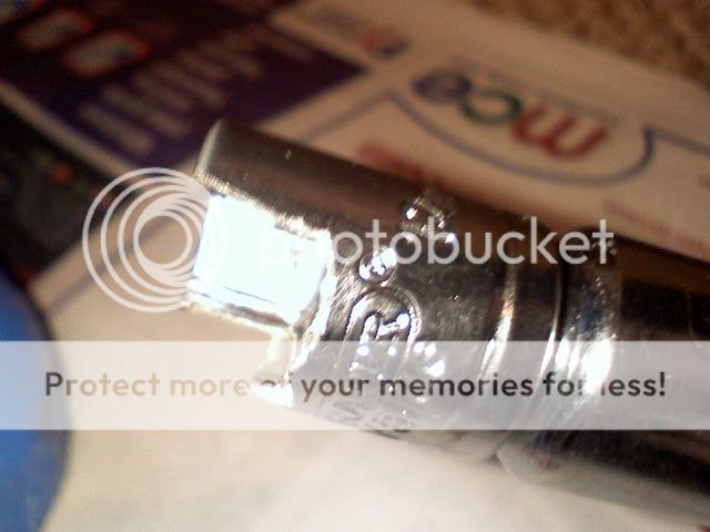

Adam got a draper value socket set, for 7 quid (I'm sure some of you are guessing what happens later Razz ) so we were able to drop the engine today. It was amusingly light by the way, we litterally were wondering where the hell the other bolts must be, as I had my arms underneath and it didn't feel any different, the engine was carried up to Matts room, and stuck in our patented engine storage system:
https://i35.photobucket.com/albums/d170/tristanthe/1121071852251.jpg
https://i35.photobucket.com/albums/d170/tristanthe/112107185253.jpg
Sorry about phonecam quality, and yes, the clutch cover is a much nicer colour than the rest of it Thinking
Anyway, now we had the mighty power of budget sockets we could whip of the head, or could we...

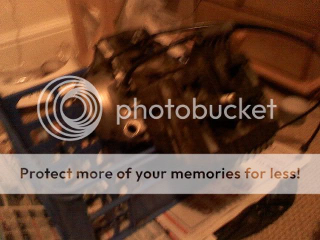

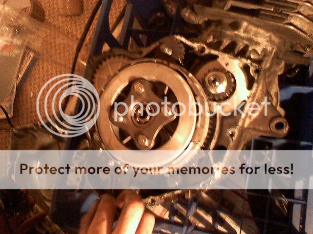

Well we wanted to do something vaguely usefull, so we went at the clutch cover, hoping to find out why it was seized, unfortunatly the bolts proved a match for not only our draper value sockets, shattering the 8 mil, but also my bloody halfords pro ratchet Evil or Very Mad and even more annoyingly than that, they then came off easily using a socket from Matts multi tool from the bloody pound shop, which I refuse to let touch my bike.
Anyway, bolts off, I wanted to put it in the oven but we weren;t sure his housemates would appreciate it, so a hairdryer was nabbed, and after using far more leverage than we should of then...
https://i35.photobucket.com/albums/d170/tristanthe/112107195902.jpg
So yeah, we had the clutch cover off, unfortunatly we realised none of us have any experience with clutches, so we sort of took it apart a little, looked sheepish and covered it up with a binbag Mr. Green

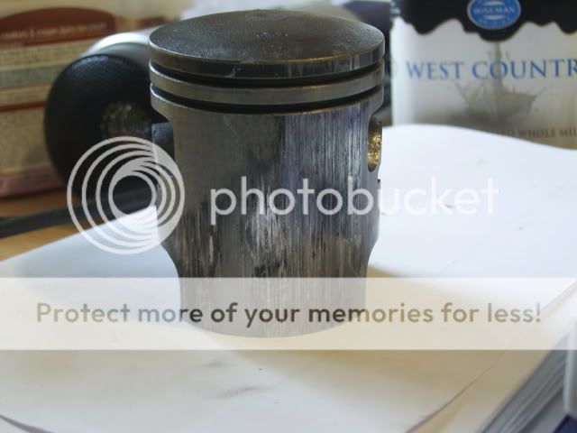

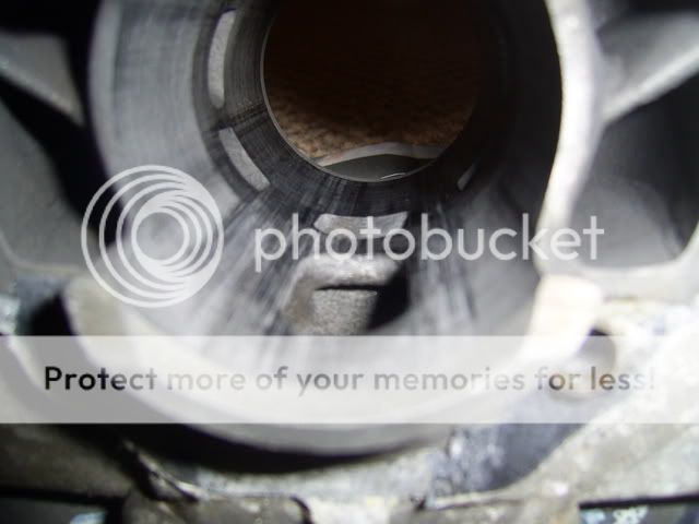

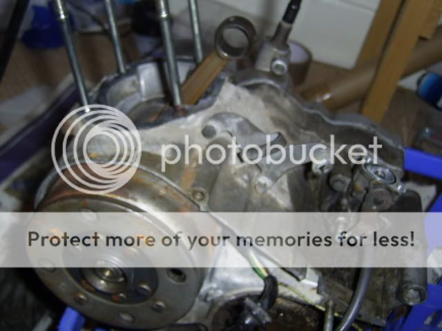

Unfortunatly when we got the head off we were greeted with this:
https://i35.photobucket.com/albums/d170/tristanthe/PIC_0027-1.jpg
Pics don;t really pick it up, but it's seized at some point, then been forcefully unseized, the conrod has a little play in it, so what we were taking as new rings, or probabky a piston at most, due to its ease of turning over has turned into almost a full rebuild, the conrod's OK, but we'll have to replace the big end bearing, to hopefully remove that play.
So yeah, crap day, we sized up our options:

PostPosted: 01:49 - 25 Nov 2007    Post subject: Reply with quote
The barrel doesn't look that bad. Bit of a mess on there but doesn't look like any deep scores.
Normally with 2 strokes the big end comes as a kit with the con rod.

Anyway, Day six.
Popped down to the breakers, to see about a s/h topend, there was an alright H100 there with most everything except a top end, and he's going to have a dig around, so we'll pop back on wednesday, with a list of things we might be able to pick up.
Got 4 spray tins of primer and 4 of satin black from the pound shop, and a few other bits and bobs, then we went to Cap'n Jaspers and had lots of food.
Stripped the rest of the frame on the evening, ready to start the proper restoration.
I dont seem to have any photos of saturday Embarassed might see if anyone else does and sneakily edit them in, in the meantime here's one of the Piston:
https://i35.photobucket.com/albums/d170/tristanthe/PIC_0051.jpg

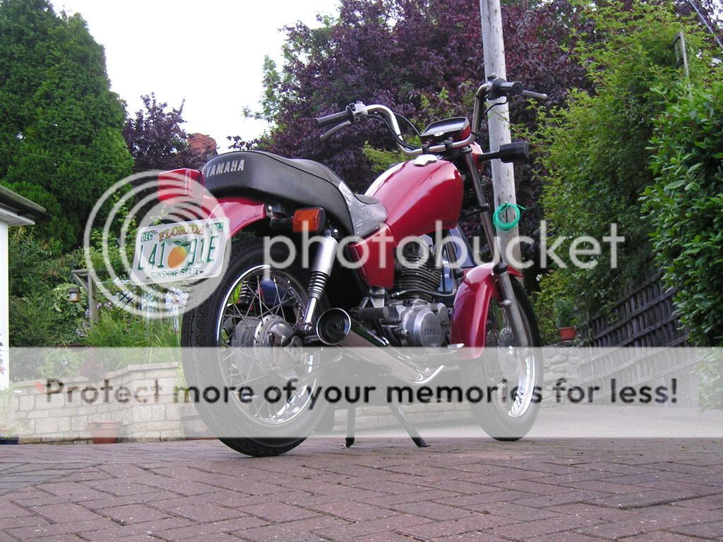

If anyones wondering what this illusive sr project looked like heres a quick idea of what i started with and what i finished with. Enjoy Very Happy
At the start:
https://i171.photobucket.com/albums/u318/Spearson18/P1010016.jpg
https://i171.photobucket.com/albums/u318/Spearson18/P1010017.jpg
Once finished:
https://i171.photobucket.com/albums/u318/Spearson18/P1010058.jpg
https://i171.photobucket.com/albums/u318/Spearson18/P1010044.jpg
Though i should add something even if it osn't constructive, scince i hav not said much yet. But hopefully the H100 will turn out the same way my last project did. Thumbs Up
'05 Yamaha Jog R (in fancy plum) sold to a chav, '91 Yamaha SR125 (stripped and rebuilt) sold to an Australian, '88 Honda H100S (crap) bought by 3 retards

Day six (again)Adam's sent me the photos for the morning (and most of the afternoon Very Happy ) of saturday, when I was asleep, so this is like a flashback, only not.
Anyway, the frame at the start of the day:
https://i35.photobucket.com/albums/d170/tristanthe/112507135335.jpg
the rest of the bike:
https://i35.photobucket.com/albums/d170/tristanthe/112507135313.jpg
https://i35.photobucket.com/albums/d170/tristanthe/112507133033.jpg

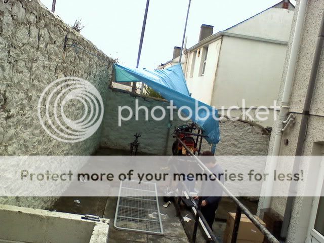

Comparison between Elsie the H and Alice, my NSR:
https://i35.photobucket.com/albums/d170/tristanthe/112507135405.jpg
Also gives a good shot of our shed, with custom built bike ramp.
