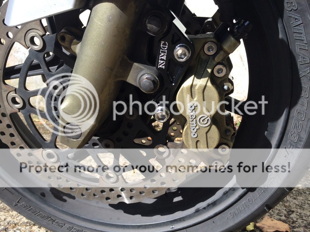

Shame I didn't see this, as I have a spare in my garage doing nothing, since I did this last year, if you think your brakes are good now, imagine if you had this.
https://i1312.photobucket.com/albums/t525/wotsthestory/Bike/DBB91C23-E9D6-432C-AC35-0B4C36CDF08E_zps57ujmg1e.jpg~original

Check the disc size, as I've got some spare discs and they'd look great on there and probably improve it yet further.

Well that's interesting. So you got an adapter to fit brembo brake calliper on?
Well look at the website it says that ER-5 fits:
OD:280mm
So do these discs have different metal compositions from stock EOM ones?

I bought the calipers and the brackets together. There was a place that did them I think. I was lucky and picked them up cheap off eBay.
The discs are likely to have much less fade than those you have.

Those callipers are Ducati items, I think off a Ducati Monster before they went to radials. They are immense, but the forks dive heavily.
