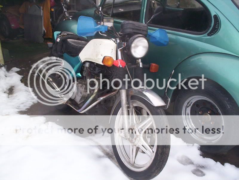

Just because I can, and it'll help me keep track with things as they need doing/get done...

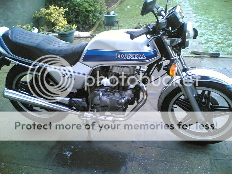

This is how I bought the superdream in 2005... eBay non-runner, it set me back £105. My misses has already struck and it is now known as Scooby... (apparently Scrappy was too obvious)
https://i127.photobucket.com/albums/p157/Kal_hybrid/Bike/CB250/CB250N.jpg
Before I bought it the Superdream had spent at least a year sitting in a field as it's previous owner had been banned. After I bought it ended up in my garden (I wasn't licenced at the time), It spent the best part of three years sitting in the garden under a bush before I got garage space for it.

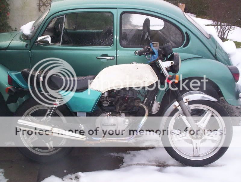

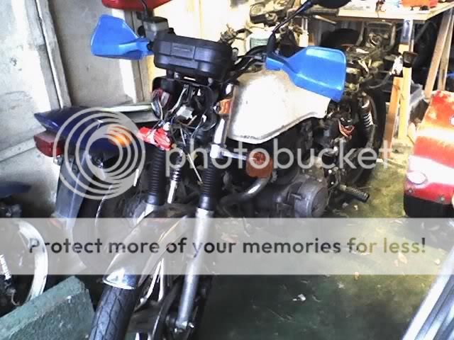

And this is how it looks now (2009) it is mostly running... So far I have invested nearly £300 in parts and labour to get it sorted.
https://i127.photobucket.com/albums/p157/Kal_hybrid/Bike/CB250/CB250nSuperdream001.jpg
https://i127.photobucket.com/albums/p157/Kal_hybrid/Bike/CB250/CB250nSuperdream002.jpg
The tank had to be swapped for an item that Lesters had to hand as when I visited them there was a pinhole in side of the petrol tank which was spraying high pressure petrol 8 inches away from the bike.
Pictures make the bike look a lot better than it is. The tank is painted in Gloss housepaint, comeplete with brushmarks, ridges and runs in the paint.

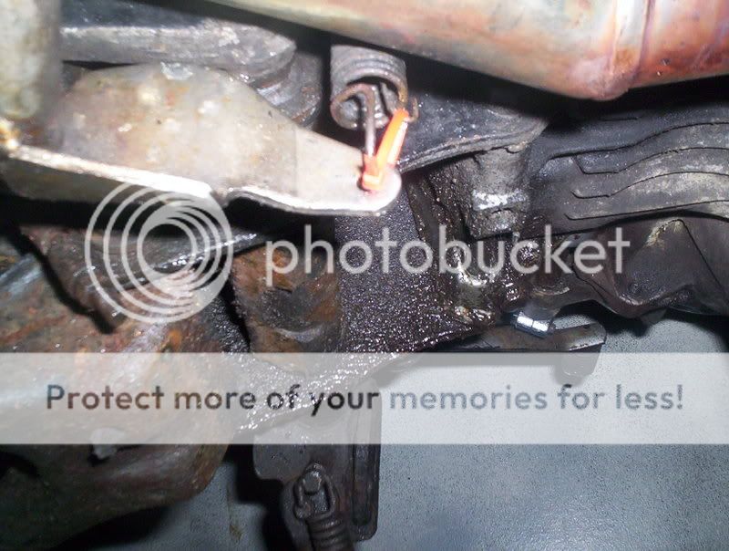

The front indicator housing was smashed while I was at work in town. As the brake pedal moved and the exhaust was loose afterwards I believe it was dropped on its side by someone 'playing' on it.
The spring for the brake switch was in the wrong position, so I have used a cable tie to bridge the gap and that seems to be working fine now.

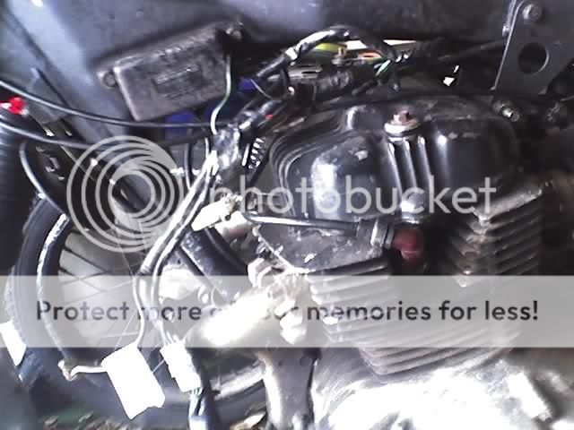

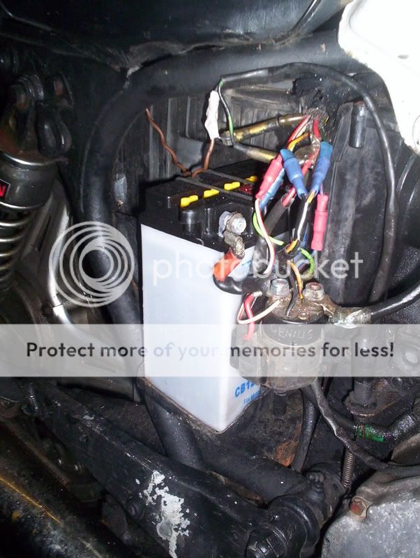

A visit to Odie to get the carbs balanced and track down the running problems suggested that it is the wiring that is causing most of the running problems.
https://i127.photobucket.com/albums/p157/Kal_hybrid/Bike/CB250/CB250nSuperdream004.jpg
What's not showing so well there is that the solinoid is wired backwards, additional earths have been added to make things work, there are connections where the wires have just been twisted together and wrapped in cellotape.
In short it's a bit of a mess. A CB400T wiring harness is on its way, hopefully that should be a straight swap for the Harness on it at the moment.

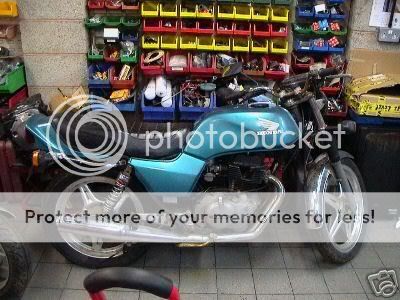

I think you're mistaking the CB250n for an RD250 Wink
A mint bike for £475.
Clicky
I also saw another mint one go for £451 not long ago.

I think this one is a better example, I bought mine for £265 no tax or mot, nowhere near mint. 400 engine though, so not original either.
Dont forget the fact the your cam chain is slacker than a "whores draws" and that there is no adjustment left on the tensioner, air filter has seen more dirt than a cat litter box, the carb to airbox rubbers have no clips round them and are held on with tap (loads of air leaks so filter not working properly anyway) and your valve clearance's need doing.
On the good side you have 175 psi per pot and your carbs are balanced Thumbs Up

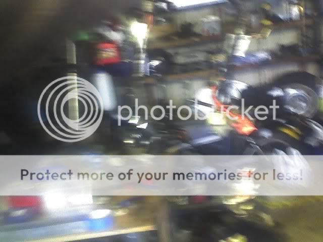

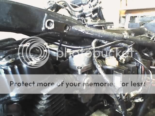

I was going to work on the drive and lay everything out piece by piece to record it as I went, sadly 5 minutes after I started it started to rain (we had brilliant sunshine when I was running errands this morning!)
Anyway, I thought I'd upload as I am having a halfway coffee and stretching my back out.
https://i127.photobucket.com/albums/p157/Kal_hybrid/Bike/CB250/11-02-09_1354-1.jpg
Safely into the garage for me to continue. As I am taking the loom off I have decided to change the headlight for the one off of the CG - I prefer a squarish light on a rat.
https://i127.photobucket.com/albums/p157/Kal_hybrid/Bike/CB250/11-02-09_1355.jpg
I was hoping to illistrate what I am doing to keep the loom aligned with the bike. Everytime I take a connection apart I am wrapping both sides in masking tape and assigning it a letter.
Hopefully it should make the rewire less painful.
https://i127.photobucket.com/albums/p157/Kal_hybrid/Bike/CB250/11-02-09_1402.jpg
Stripped back to the engine. This stumped me for a couple of minutes until I decided...
https://i127.photobucket.com/albums/p157/Kal_hybrid/Bike/CB250/11-02-09_1414.jpg
...to take the engine mount off. After this it was a lot easier.
[https://i127.photobucket.com/albums/p157/Kal_hybrid/Bike/CB250/11-02-09_1421.jpg
Check it out, the red wires had been twisted together and wrapped in cellotape!
https://i127.photobucket.com/albums/p157/Kal_hybrid/Bike/CB250/11-02-09_1446.jpg
Success! The multi-headed snake has been conquered. Coming next, the replacement.

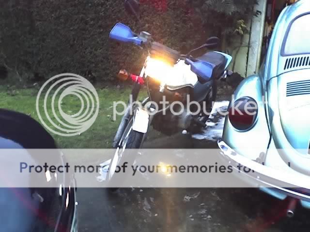

Completely working front main and dip light, rear light working (but is constantly on as the brown ignition wire appears to have a fault. I cross wired it so it is constantly on) Brake light works, starts on the button (thanks to another solinoid I found at the bottom of my electrical salvage box), rear inidcators work.
The bad news. At some point in the late stages of the rebuild the front inidcators stopped working and I don't know why.
I shall be going back out to have another crack at the wiring once I have posted here.
https://i127.photobucket.com/albums/p157/Kal_hybrid/Bike/CB250/15-02-09_1643.jpg

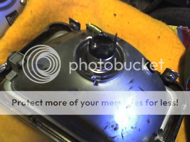

I spent all afternoon pouring over the wiring, mostly in the housing and the wiring diagram (which now has extra notes!)
https://i127.photobucket.com/albums/p157/Kal_hybrid/Bike/CB250/15-02-09_1644.jpg

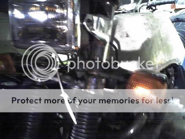

It was only after I a bulb working acorss the front and not the rear that I realised I had wasted the day trying to workout what I thought was a single problem that was actually two completely seperate problems!
https://i127.photobucket.com/albums/p157/Kal_hybrid/Bike/CB250/15-02-09_1656.jpg
The light bulb from the CB250 light didn't want to fit in the casing from the CG125W and to complicate things the CG125 bulb really didn't want to work.
Fortunatley I have a CB500 item that I purchased a while ago in my spares box and the rim on that was small enough to sit in the CG125 housing. The only issue were the flanges on the rim of the CB500 bulb, they were far too big. Having come this far I wasn't about to let something like that stop me and got the tin snips out to trim the flange.
Result a bulb that fit the housing and works. Thumbs Up
https://i127.photobucket.com/albums/p157/Kal_hybrid/Bike/CB250/15-02-09_2249.jpg
https://i127.photobucket.com/albums/p157/Kal_hybrid/Bike/CB250/15-02-09_1710-1.jpg
Now if you will excuse me I have to find out why my front indicators aren't working when my rear ones are.
Kal...

Ka'Plah!
The word for today is bodgtastic. At some point I need to get some OEM type connectors soldered onto the loom for a permanent repair - however the halfords ones are on at the moment and working!
Given the issues that were going on I decided to junk the Superdream inidcators and fit some NTV ones I had lying around in a spares box.
Before fitting them I tested them by using the power and earth on them to bridge the gap on the solinoid. Sure enough both had good bulbs and wiring.
I decided to fit them. Unforunately no matter how tight I cable tied them they showed a worrying tendancy to move when mounted high up where I wanted them, so I've mounted them only slightly higher than the OEM ones and used the original spur to anchor cable ties to stop them being pushed backwards.
Much experimentation led to me fitting an additional earth in the headlight and then connecting the three main lighting earths to it. Connecting is a good ephamism for what has been perpetrated - but hopefully I will get that sorted very, very soon!
Saldy all of the experimentation led to the expiry of the relay. Fortunately I had come across a spare earlier in the weekend. Now the spare relay I found is a fair bit deeper and has an irritating sounder on it. It took me a while to place when and why I had purchased it. A couple of years ago my girlfriends Escort had some indicator issues and I had bought this is to see if it was the relay that weas the problem - it wasn't and needed some proper attention but I kept the relay.
Anyway much wire cutting and fiddling later and I have it up and running. All electrics working within the legal requirements, it now starts on the button everytime and no longer has the starter trying to engage everytime the front wheel is over to the left!
I took it out for a belt when it was done, and it had all of the old problems straight off of the bat.
It struggled, the camchain rattled and it was a complete dog. However within half a mile it had warmed up and it was like riding another bike.
Lots of fun, although I could have done without the roads being so greasy, having the entire bike slide sideways in a comparitively slow corner was a little more excitment than I needed!

Yikes. Off the road again. Monday morning saw the superdream fail to turn over and instead it just made a nasty click-click noise.
Seeing as the starter relay I fitted the other week is of unknown vintage I have ordered two new ones off of eBay. Hopefully they will be here soon!
Kal...
Blue_SV650S
Joined: 27 Nov 2008
PostPosted: 19:57 - 11 Mar 2009    Post subject: Reply with quote
Are you sure it isn't a flat battery?
Short out the terminals on the relay/solenoid to establish which ...
p.s. I ran a superdream for years ... great little bikes (for cheap commuting) they cost nothing to run and just go and go and go!! Thumbs Up
Kal
Joined: 02 Jan 2007
PostPosted: 10:44 - 12 Mar 2009    Post subject: Reply with quote
If it is I am going to have a red face. There is no spark across the terminals on the relay, otherwise I'd have just shorted it to get to work all week.
Electrics except for starter are working. The battery itself was brand new a couple of months ago and the alternator was replaced at the same time but the starter relay I am using came out of the bottom of my salvage box so I am hoping it is that.
Kal...
Blue_SV650S
Joined: 27 Nov 2008
PostPosted: 11:19 - 12 Mar 2009    Post subject: Reply with quote
Your RR could have given up/bad connection or the battery could have simply failed ...
Have you tried bump starting it?
Also try a set of jump leads from a car ....
