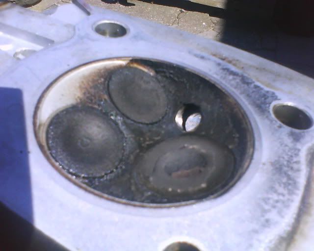

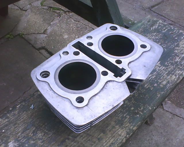

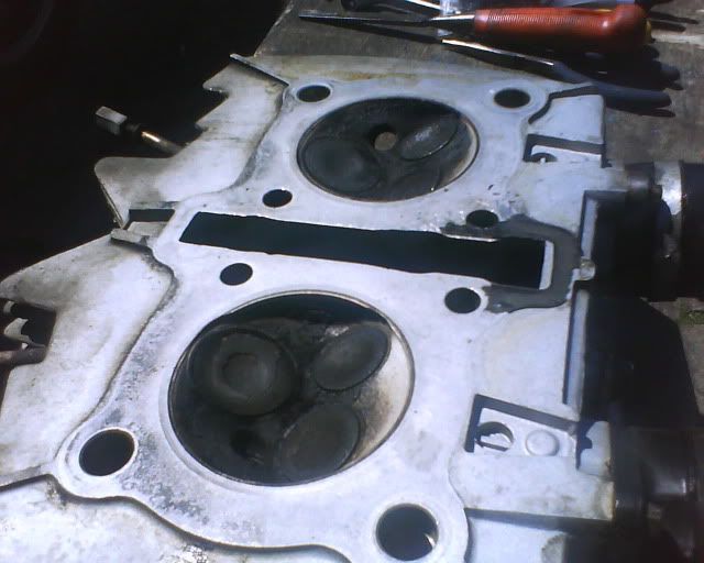

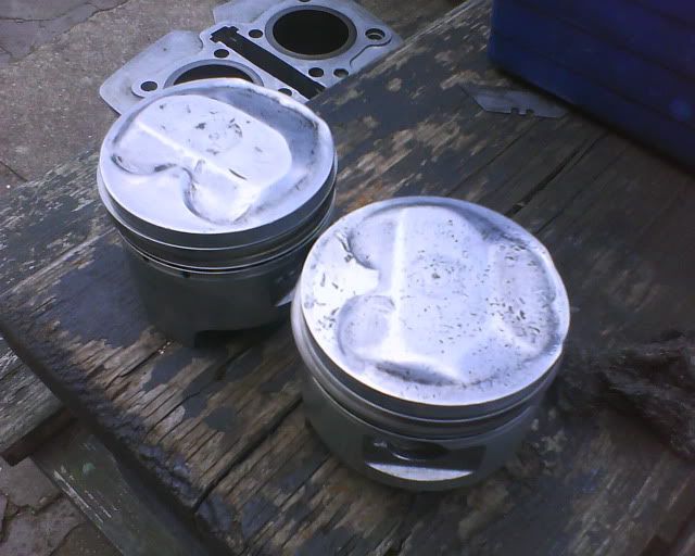

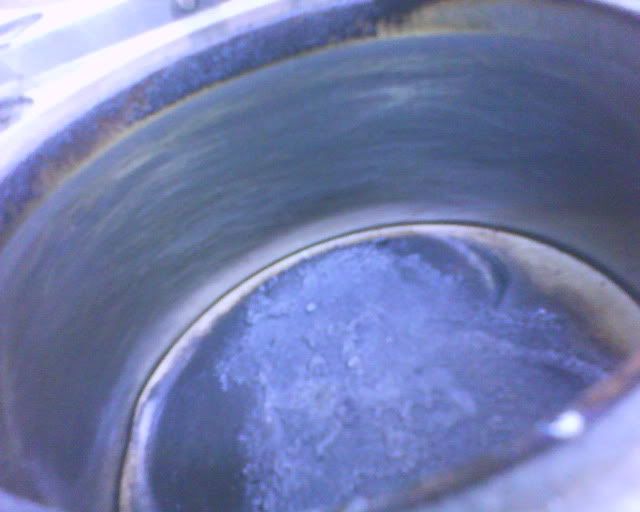

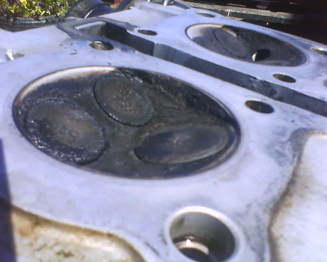

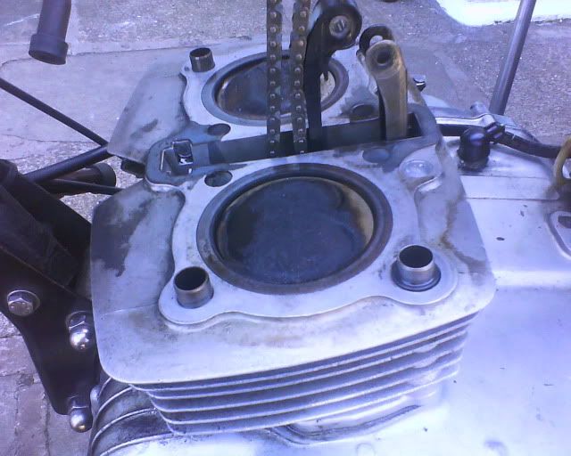

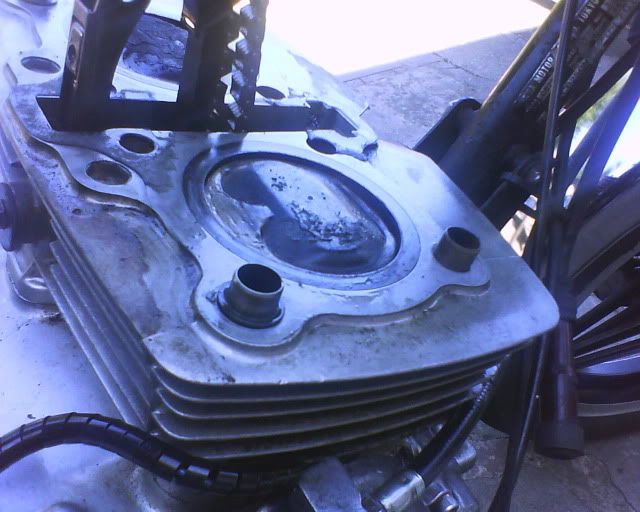

Here are some pics of the top end of my superdream. It didnt seize or break down or anything, im just rebuilding it as i have the week off and the head gasket was leaking and it burns oil Laughing .
https://i101.photobucket.com/albums/m62/ant-147/DSC000148.jpg
https://i101.photobucket.com/albums/m62/ant-147/DSC000157.jpg
https://i101.photobucket.com/albums/m62/ant-147/DSC000167.jpg
https://i101.photobucket.com/albums/m62/ant-147/DSC000176.jpg
https://i101.photobucket.com/albums/m62/ant-147/DSC000186.jpg
https://i101.photobucket.com/albums/m62/ant-147/DSC000195.jpg
This being the first 4-stroke ive owned/worked on i havent got a clue if the above pics tell me anything substantial. Am i missing anything obvious or does it all look fine?
My plan is fit a new top-end gasket set and new piston rings all round. What should i be doing with the valves? I was planning on just cleaning everything, getting the excess carbon off and and re-assembling.
Just wondering if im missing anything obvious or any recommendations on what to do or check before i re-assemble?
One thing i noticed is the RH piston is slightly wet with oil whereas the LH piston was dry. Im wondering if this is linked to the fact that when the bike is really warmed up it smokes slightly from the RH exhaust when idling or pulling away.
Cheers for any help, Ant Thumbs Up

I got the 250n superdream and does excatly what yours does! i just brought another engine and going to swap it as so cheap!
You are doing a good job i would just replace gaskets pistons and rings, don't really need to replace anything else unless really bad, good old clean will help loads!

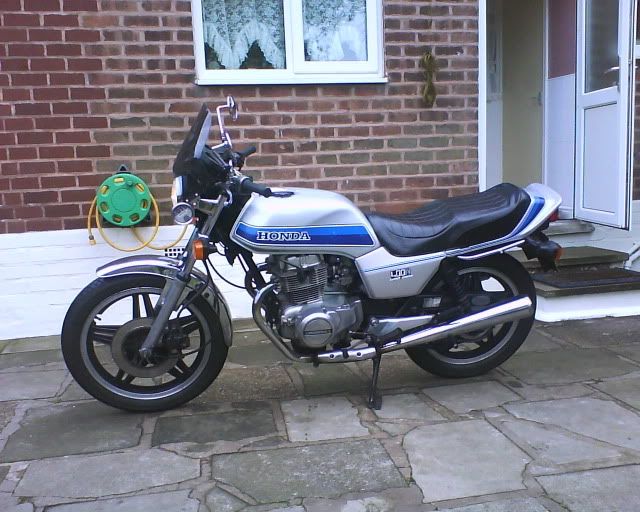

Thanks Thumbs Up My bike started out as a 250 too. But when i bought it, it had had a 400N engine put in. The problems were there when i had it but they are gettin gradually worse and the oil consuption heavier so now is the time to do it. I did have a look around for a second hand engine but the last 400N engine i saw on ebay went for over £100 and the condition was unknown and im estimating about £70 on parts, labour done my self, so really its cheaper to do repair mine.
It has a replacement exhaust on it but in the standard style, 2 into 2. I recently put a flyscreen on it and would really recommend it if you are thinking of one.
https://i101.photobucket.com/albums/m62/ant-147/DSC000145.jpg
Screen was £20 iirc from getgeared. Thumbs Up Just need to find a place that stocks piston rings now, David silver are out of stock so will give them a ring on tuesday and find out when they will be in. Dont suppose you know of anywhere else (none on ebay atm)

Bought a valve grinding tool from halfords and was having a go with it today. Not entirely sure of the correct way to do it but it seems to have tidied them up at least. I'll test the seat when i come to re-assemble and hope for the best.
I found my vernier gauge today aswell and measured the pistons. I was looking for 62mm for standard pistons but it was 71, after about 10 minutes of thinking WTF, I then realised that i reading the section for the 250N, and sure enough the 400N spec said 71mm. Doh! Laughing

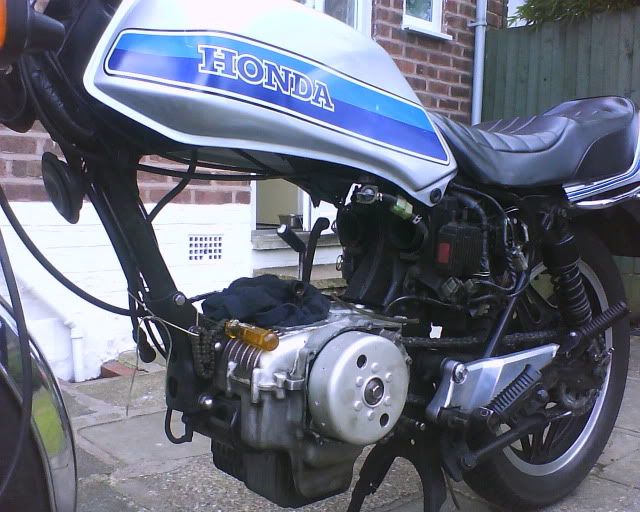

Anyway, heres what i have done so far, just cleaned everything really. Got the old gaskets off and excess oil in the fins. Bore is real smooth and the pistons look in real good condition so im not going to be too worried about putting them back as they are. Just new rings and gaskets will do.
https://i101.photobucket.com/albums/m62/ant-147/DSC0001510.jpg
https://i101.photobucket.com/albums/m62/ant-147/DSC0001610.jpg
https://i101.photobucket.com/albums/m62/ant-147/DSC000179.jpg
My bike looking very sorry for itself.
https://i101.photobucket.com/albums/m62/ant-147/DSC000198.jpg
Im going to soak the parts in parrafin or something incase theres any excess on there. With any luck i will be done within the week depending on parts. Im also waiting on a new back wheel, last week while i was riding the sprocket circlip snapped. I managed to get it home with a jubilee clip from halfords but its worn away at the hub so ive just bought a new set of wheels for the rear with full sprocked assembly for £26 all in.
