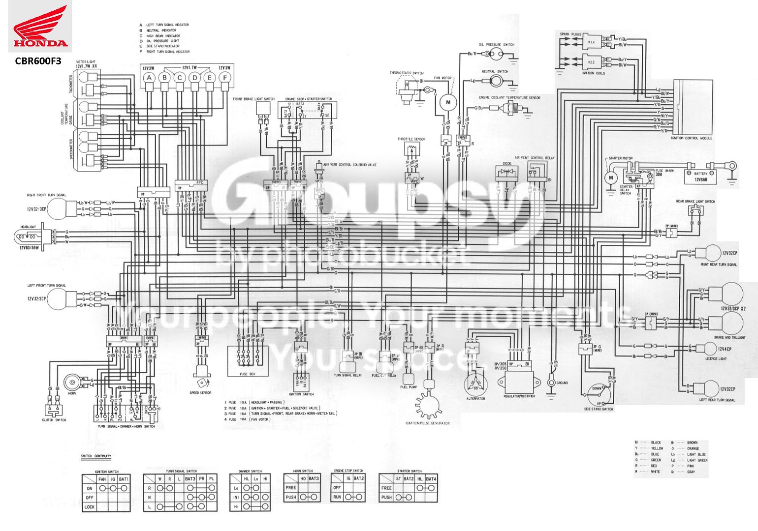

Got her running Very Happy Turns out they blew the main fuse.
Anybody know what the third wire going to my ignition is for? Doesn't affect anything regardless of what we do with it, but it's a pretty chunky wire. It's the blue one for anybody who knows these bikes.

Google is your friend... From our very own BCF "wiring diagrams" thread none the less!
Wiring Diagram: https://i574.photobucket.com/albums/ss182/hmmmnz1/Honda/cbr600f3.jpg
Wiring diagram thread, courtesy of hmmmnz (give him some karma if his thread helped you!): https://www.bikechatforums.com/viewtopic.php?t=184540
From what I can see, blue/orange wire goes to the rad fan! (via the fusebox).

Fantastic, I did look, but I was looking at F2 (thinking american model codes) and it wasn't making sense!
I'll make sure I don't sit in traffic any time soon then, I won't be doing the new ignition until Sunday. Until then it's hotwire time!
