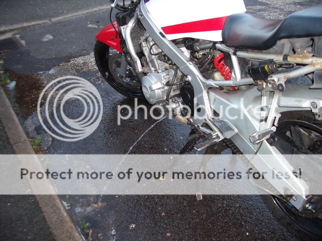

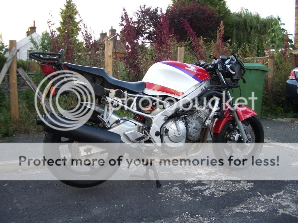

Earlier this week I managed to grab time over a couple of evenings to get a bit more done. I adjusted the chain properly and went around the bike with a torque wrench tightening up all the various bits I’d messed with over the years.
This is a picture from the other day. This is my bike having a nice hot piss in the gutter before I refilled it with proper coolant.
https://i221.photobucket.com/albums/dd227/serendipity_uk/CBR600FR/IMGP7549.jpg~original
You can see quite clearly why I thought it would be a good idea to slap some Hammerite on the subframe. I’ll get around to doing it one of these days.

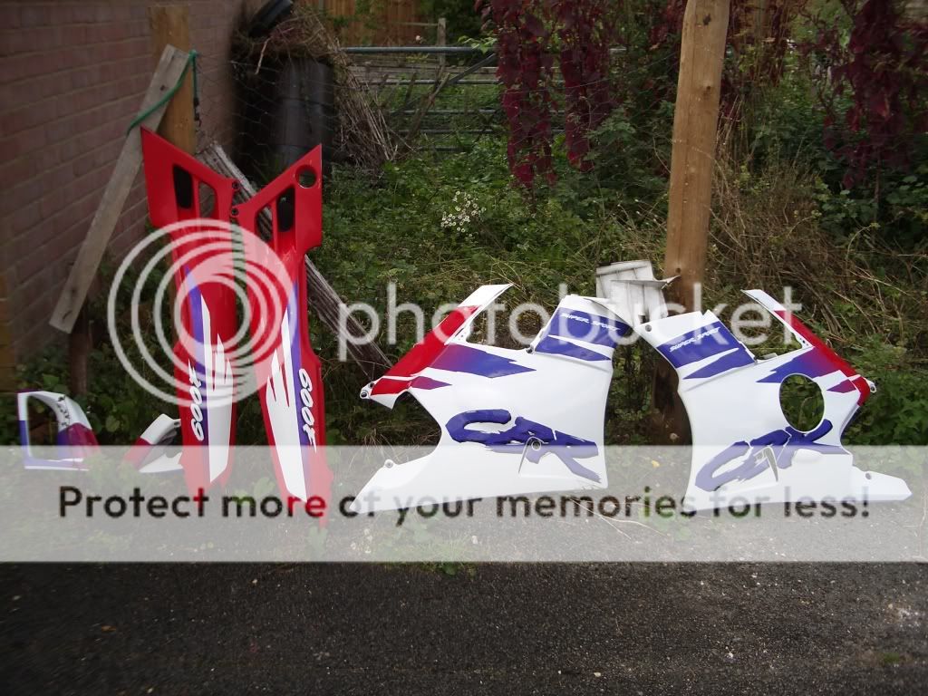

I fitted the top fairing, screen and mirrors during the week, but stopped with the rest of the bodywork because I was still wondering about the state of the shock. It feels like all the damping made a break for the hills during the bike’s extended rest. I spoke to Hagon and they reckon they can probably do a rebuild, but it depends on how old the shock is. I can’t remember exactly when I bought it, but I bet it was the best part of ten years ago.
In the end I decided I’ll put it through the MOT anyway and see what transpires. Regardless of whether it passes or fails I’ll send the shock off as soon as I can.
So I delved behind a huge pile of RXS bits, paddling pools, bits of wood and bicycles to retrieve the bodywork. It was caked in a splendid mixture of mud, salt, spider corpses, dust, cobwebs and oil. After half an hour with some paraffin, Muc-Off and hose action it looked like this:
https://i221.photobucket.com/albums/dd227/serendipity_uk/CBR600FR/IMGP7550.jpg~original
Then it only took another half an hour or so (including repairing a cross threaded fairing bolt) to transform this (not quite, because as mentioned I had already fitted the top fairing):

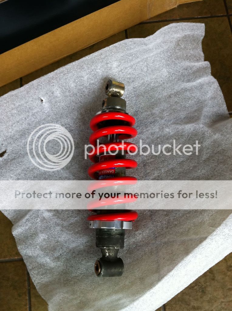

A nice man in a van brought this to my door today:
https://i221.photobucket.com/albums/dd227/serendipity_uk/CBR600FR/Photo25-08-2011105506.jpg~original
A quick unwrap revealed a freshly rebuilt shock all the way from Essex. Same spring and slightly corroded old body, but all new internals and a few new shiny bits like a new preload adjuster ring and new copper bushes.
https://i221.photobucket.com/albums/dd227/serendipity_uk/CBR600FR/Photo25-08-2011110049.jpg~original

All back together now and booked for an MOT retest at 9am tomorrow. A nice smooth bounce has been restored to my rear end. Wink
I sorted out the stiff throttle by lubricating the cables and re-greasing the twist grip. I lubed a few other pivot points here and there and topped up the oil.
The shock I just had rebuilt was already a Hagon model. I ditched the original Honda shock about 10 years ago when it reached about 60k. The Honda shock probably still had some life in it, but it was a bit tired and the bike was already in pieces because I was replacing a holed radiator so a change seemed sensible.
Hagon rebuild their shocks for a standard fee of just over £100 including VAT and shipping.

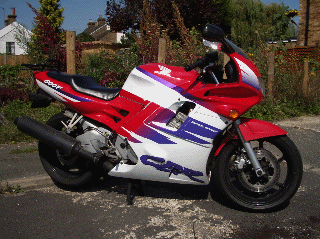

Got a green one! Cool
https://i221.photobucket.com/albums/dd227/serendipity_uk/CBR600FR/IMGP7584a.jpg~original
However, not everything is peachy. It may have passed the test, but there’s something not quite right with the transmission. It’s only noticeable when moving away slowly, but just as you feed in a little bit of power there’s a gentle CLUNK from the rear. You can’t really hear it, but you can feel it through the footrests.
The wheel bearings seemed alright yesterday so my suspicion falls on the very old chain. The chain had already been on for a few thousand miles before I fitted a Scottoiler. I can’t remember specific dates and mileage, but I guess it was around the time I fitted the Hagon shock making it 10 years and about 25k miles old. I’d been used to changing chains every year and constantly lubing and adjusting them so the Scottoiler was a revelation. The chain just stopped wearing and never seemed to need adjusting. The only time the chain dried out was when I was too lazy to pop the side panel off to fill the oiler reservoir.
Equally it could be the front sprocket. The rear sprocket doesn’t look too worn, but in my experience the fronts tend to wear into hooks quicker than the rears. I can’t remember the last time I looked under the front sprocket cover so it could be knackered. Fingers crossed there’s no problem with the gearbox or output shaft bearing.
So maybe a new chain and sprocket kit is needed. It’s another £120 or so, but probably worth it just in case the O-rings on the old chain have hardened or perished.
At least now, once I add some tax, I can get out on the road for some proper test runs rather than pootling up and down my cul-de-sac.

Cheers for the offer, really appreciated, but I’d already ordered a new chain and sprockets to fit together.
The CBR is actually a 530 chain. My CB500 uses a 525 and the CBR6 puts out an additional 42BHP (on paper at least) so I’d expect a slightly meatier item on the sporty bike.
I went for a longer ride yesterday afternoon after I taxed the bike. Everything seems to work quite well and the brakes are far better than I remember them, probably something to do with the new hoses and calliper service.. The rejuvenated suspension is a pleasure too, although I think I need to play with the setting on the rear. Fortunately the dreadful state of our country’s roads gives me plenty of uneven surfaces for testing.
So have a last picture of the CBR all together before I pull all the panels off again. It's a teeny bit grubbier than before after riding it through all the wet weather yesterday.
https://i221.photobucket.com/albums/dd227/serendipity_uk/CBR600FR/IMGP7585.jpg~original
I could smell coolant after my run yesterday so I need to check for leaks again. I think there’s a very slow drip from the hose union at the base of the oil cooler onto the downpipes. I plan to drain the coolant and pull off the hose to make sure there’s no grit or cracks causing the drip.
I’m also considering renewing the camchain tensioner. It’s also debatable whether I should consider renewing the cam chain itself, but I’ll get a better idea of wear when I pull the tensioner and see how far the plunger has extended. It may be fine and I can reuse the tensioner after a clean and re-prime with oil. I’ve never played with that so it will be a fun learning experience.

A few bits turned up in the post so I thought I’d get back out there to do the work. I took a few pictures as I pulled the plastics off the bike again and used the first and last ones to make a full dress to naked morph animation. The freebie program I used only takes two photos unfortunately otherwise I’d have the whole lot coming off in stages.
https://i221.photobucket.com/albums/dd227/serendipity_uk/CBR600FR/cbr600fr.gif~original
My old airbox was missing a chunk at the front from where I had to cut out a seized screw several years ago. Managed to find a new airbox cover on Fleabay for a tenner so I took the opportunity to fit that with a new air filter element from David Silver Spares.
Next I need to fit new chain and sprockets and make sure the coolant isn’t still leaking from the bottom hose union. This probably means a coolant change while I mess about with the hoses. I’ll also change the oil as I honestly can’t remember what I poured in there a couple of years ago.
I was going to make a start on all that today, but it’s currently nice and sunny and too hot to be sweating in the garage. I’ll save that for a dull day and get out there to enjoy the weather today. Very Happy
