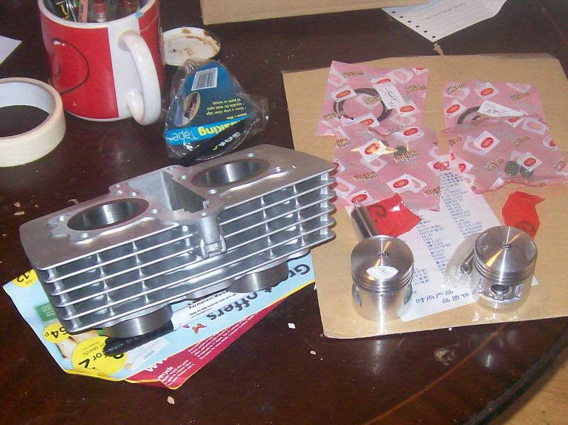

With the amount of smoke pouring out the tail, a rebor was almost inevitable. Priced up, a pair of pistons and rings are roughly £60, a rebore about £30, and then you need gaskets, so its a £100 job. Meanwhile, logistically, you strip motor down to the bottom end, thn hoik heads and barels to M/C shop and wait a week for them to be cut, while you twiddle thumbs, so an e-bay special barrel kit for £85, not only saves a couple of quid, but waiting around too!
And I had hoped to have the whole job 'done' from lifting spanner to take engine out, to putting spanners away, engine back in, in a day... in the end it took two, but still not bad going!

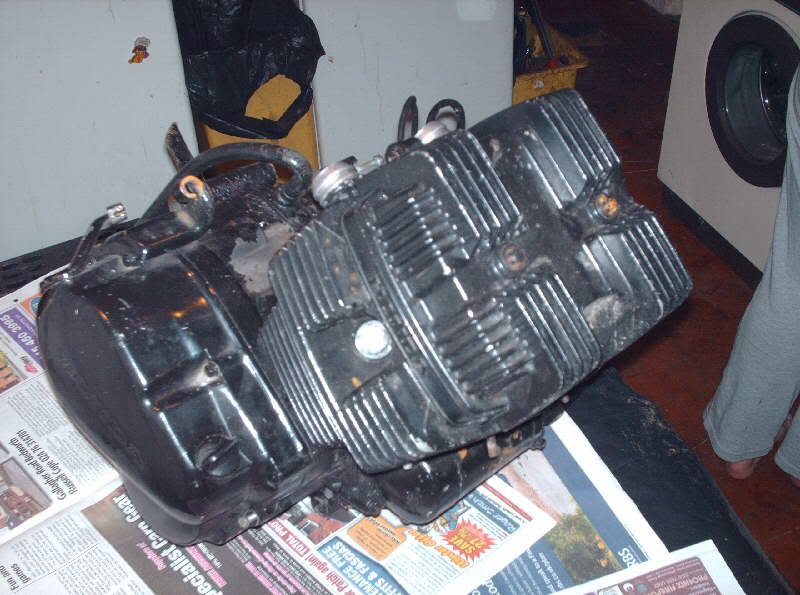

Engine out:

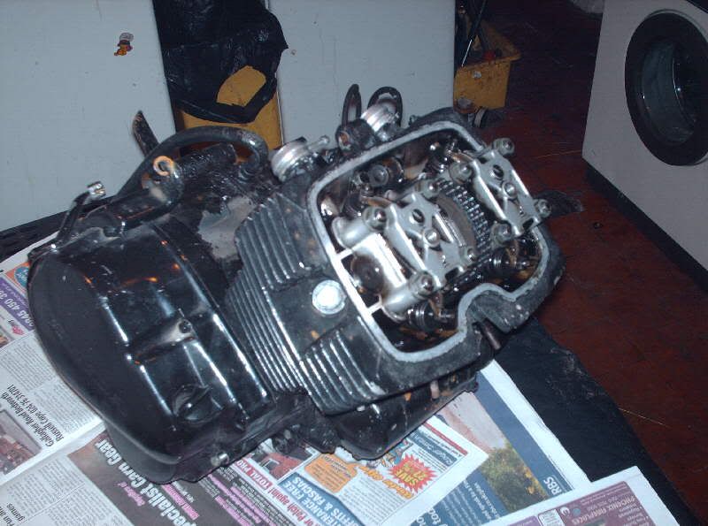

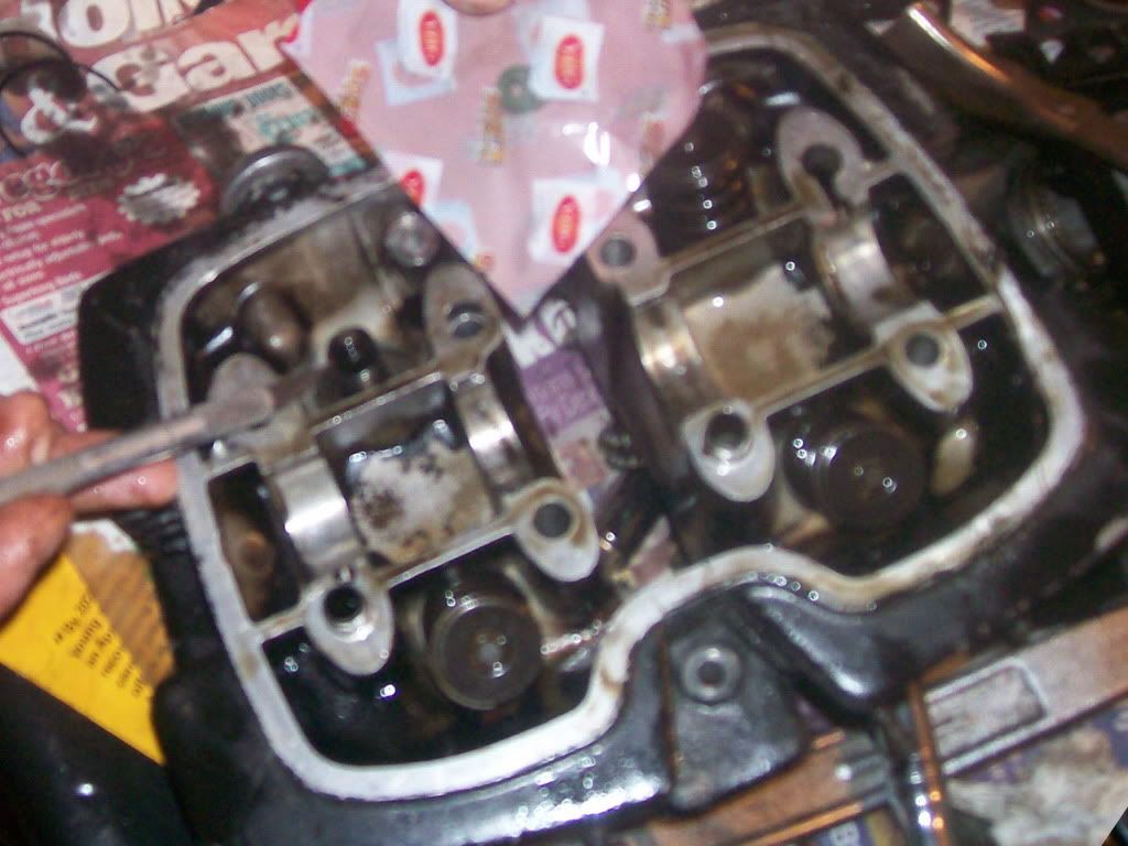

Rocker Cover 'off'
https://i178.photobucket.com/albums/w269/teflons-torque/Little%20Dreams/LD07%20Eng%20Build/imag1835.jpg~original
https://i178.photobucket.com/albums/w269/teflons-torque/Little%20Dreams/LD07%20Eng%20Build/imag1836.jpg~original

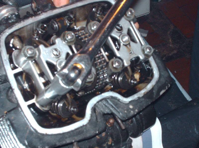

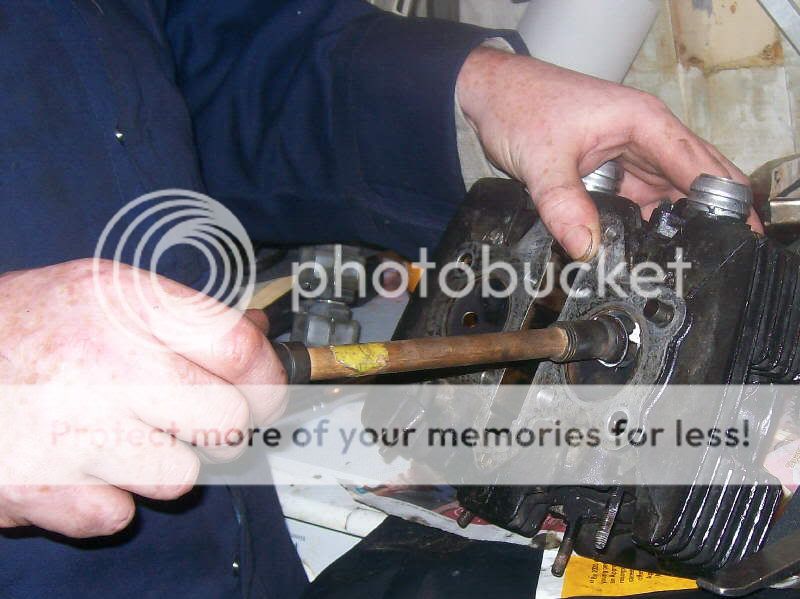

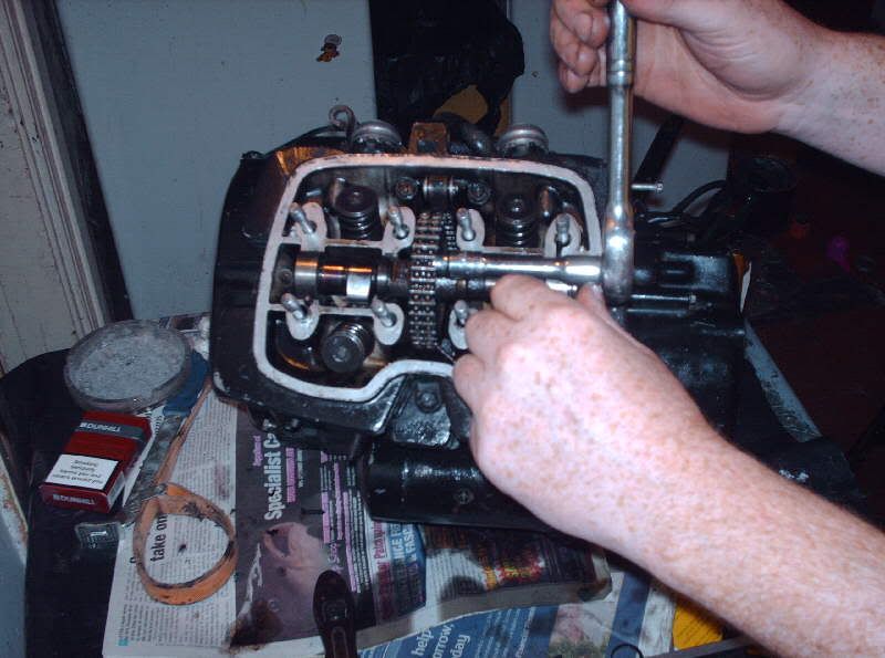

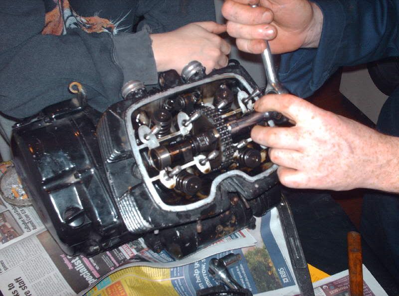

Breaker bar to 'crack off' each of the cylinder head studs, in sequence, then ratchet to wind them off.
https://i178.photobucket.com/albums/w269/teflons-torque/Little%20Dreams/LD07%20Eng%20Build/imag1837.jpg~original
https://i178.photobucket.com/albums/w269/teflons-torque/Little%20Dreams/LD07%20Eng%20Build/imag1839.jpg~original

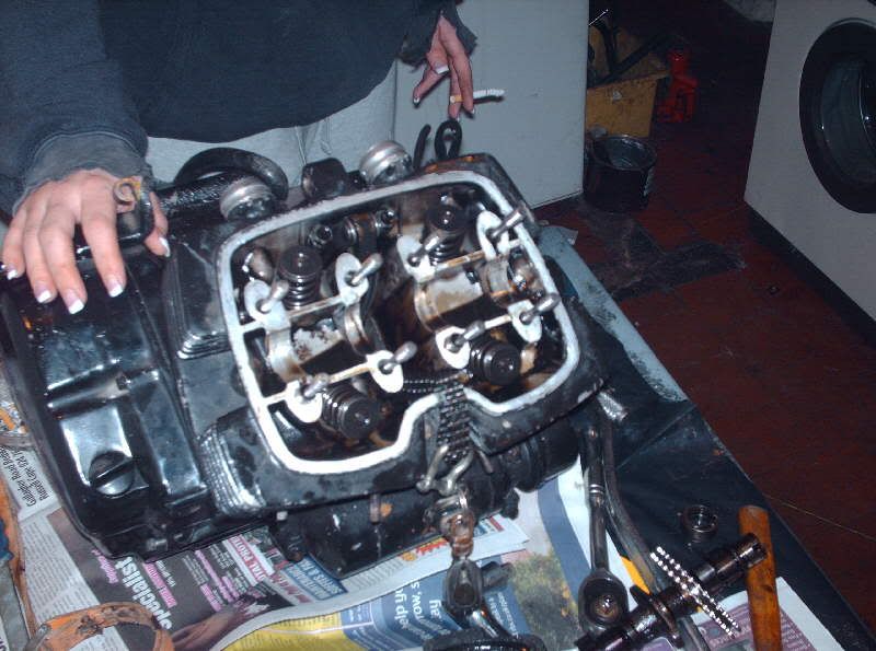

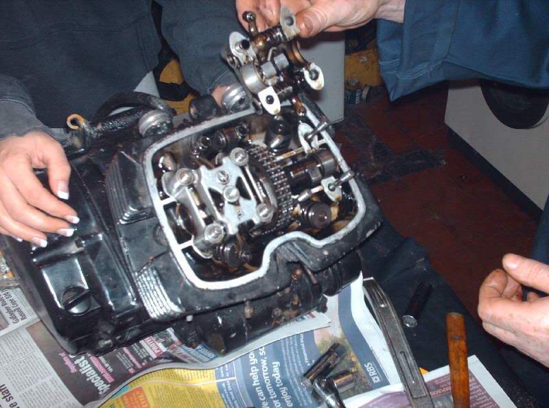

Then the rocker assemblies can be removed to expose the camshaft, and the cam chain sprocket loosened off.
https://i178.photobucket.com/albums/w269/teflons-torque/Little%20Dreams/LD07%20Eng%20Build/imag1840.jpg~original
https://i178.photobucket.com/albums/w269/teflons-torque/Little%20Dreams/LD07%20Eng%20Build/imag1844.jpg~original

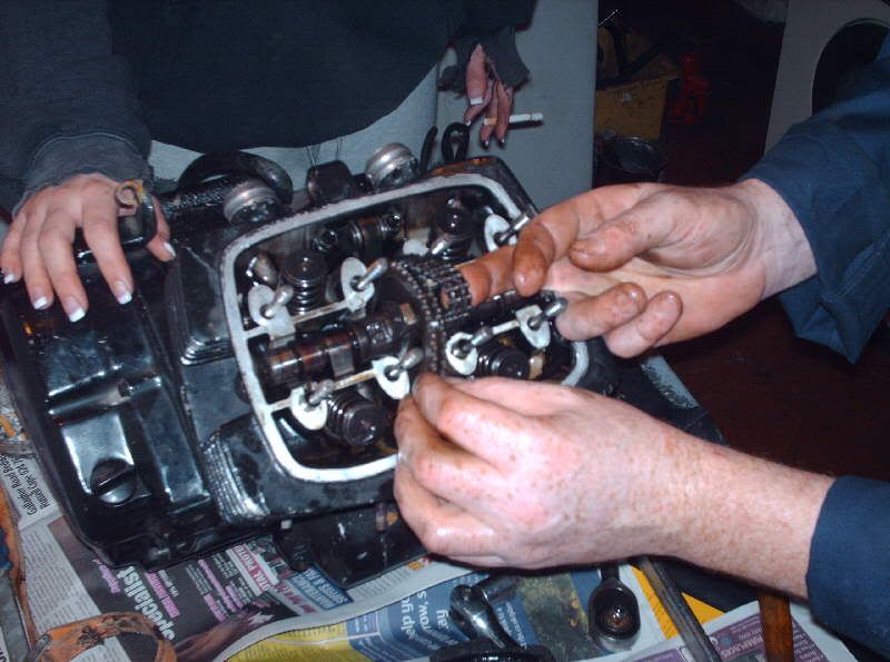

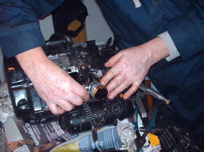

Removing the cam chain is err... fiddly! But then the cam can be withdrawn from the sprocket and head.
https://i178.photobucket.com/albums/w269/teflons-torque/Little%20Dreams/LD07%20Eng%20Build/imag1846.jpg~original
https://i178.photobucket.com/albums/w269/teflons-torque/Little%20Dreams/LD07%20Eng%20Build/imag1850.jpg~original

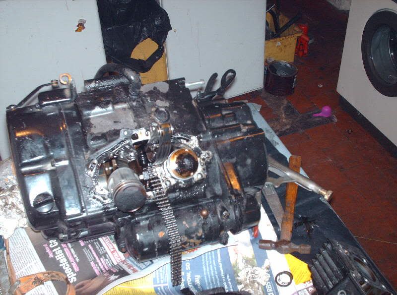

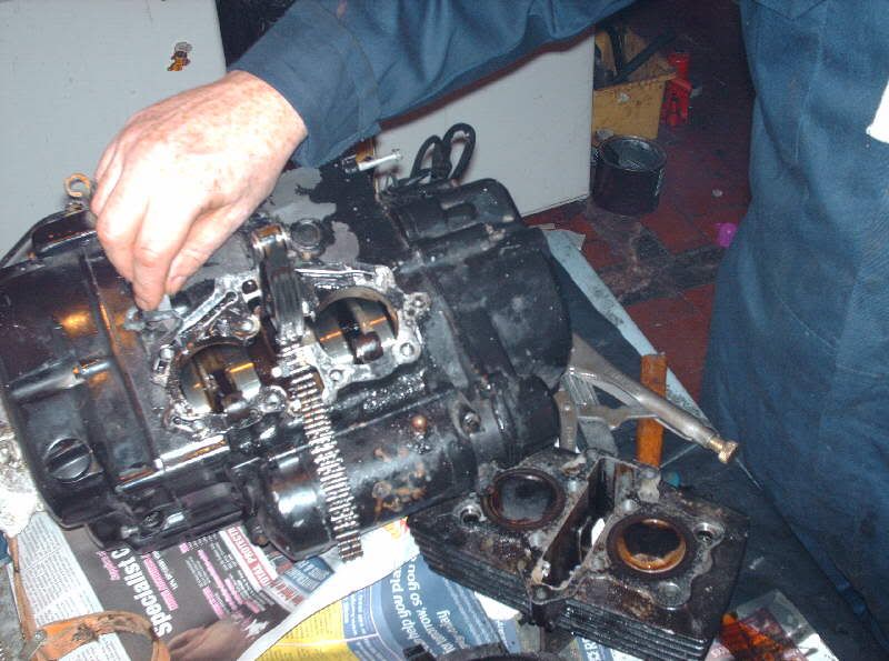

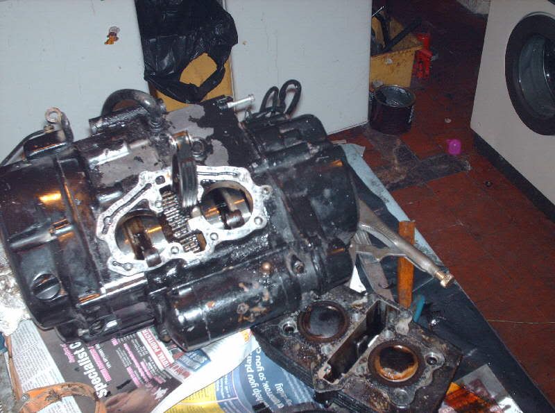

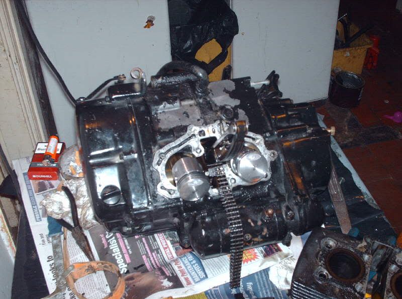

Then the Cylinder Head can be lifted off.... then the barrel. (Makes it all sound SO! easy!)
https://i178.photobucket.com/albums/w269/teflons-torque/Little%20Dreams/LD07%20Eng%20Build/imag1851.jpg~original
https://i178.photobucket.com/albums/w269/teflons-torque/Little%20Dreams/LD07%20Eng%20Build/imag1852.jpg~original

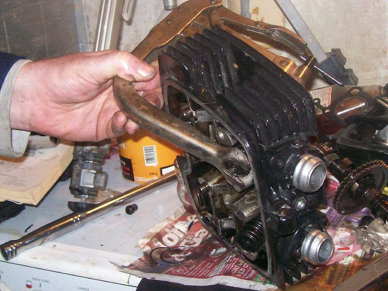

Cylinder Head studs loosened off with clever 'cam' action stud wrench, then removed.

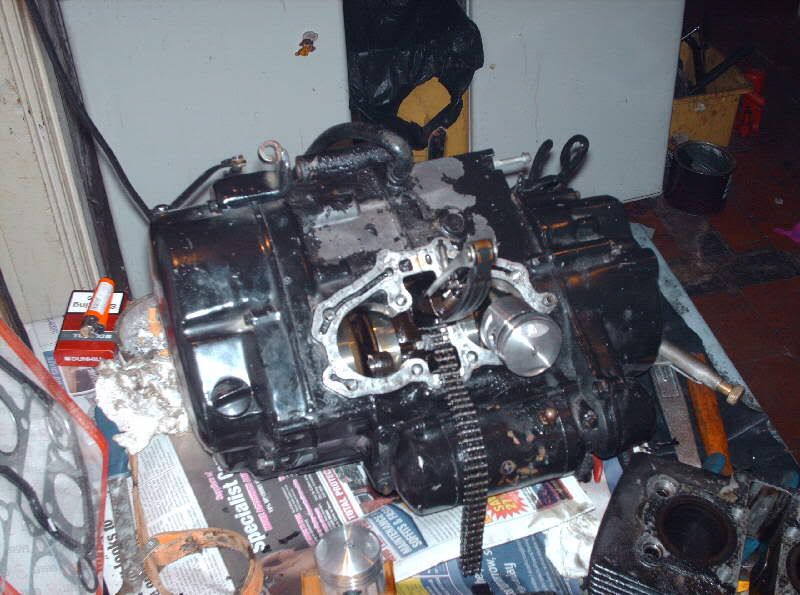

Gudgeon pin removed from piston, and the pistons removed
https://i178.photobucket.com/albums/w269/teflons-torque/Little%20Dreams/LD07%20Eng%20Build/imag1855.jpg~original
and the base gasket face cleaned up.
https://i178.photobucket.com/albums/w269/teflons-torque/Little%20Dreams/LD07%20Eng%20Build/imag1856.jpg~original

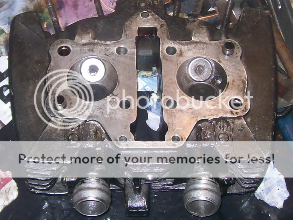

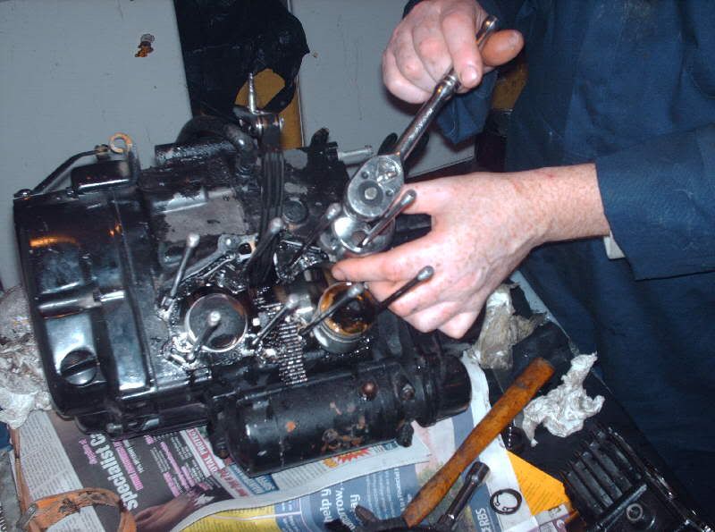

Time to strip the head.
https://i178.photobucket.com/albums/w269/teflons-torque/Little%20Dreams/LD07%20Eng%20Build/104_0258.jpg~original
Smaller of my two Valve Spring Comprssors, was just about the right size, to remove valve collets and drop th valves out.
However, see later; during 'rebuild 2', I adapted it with an old socket and some pvc insulation tape to better gt on the tiny little valves!
https://i178.photobucket.com/albums/w269/teflons-torque/Little%20Dreams/LD07%20Eng%20Build/104_0259.jpg~original
breaking with convention, that says strip the head completely, and push valves through a bit of cardboard and number them as to whers they came from, and similarly try and organise collts and springs.... I thought 'bollox', lets just do ONE valve at a time!

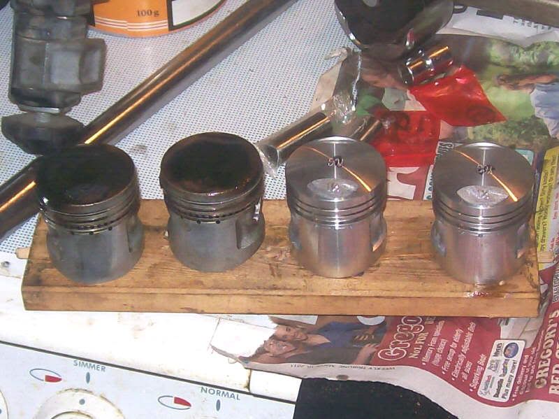

Pistons, New & Old
https://i178.photobucket.com/albums/w269/teflons-torque/Little%20Dreams/LD07%20Eng%20Build/104_0253.jpg~original

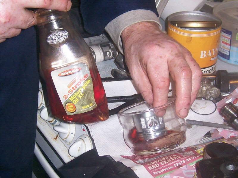

As verything during rebuild, it has to be lubricated so that there is 'something' ther to protct baring faces when you first wind the engine over, before starting it and gtting oil pressure.
I use LM or lith grease on most barings and things like the cam-chain and rocker assemblies, as this gives a good 'coating' of lub that dosn't drip away lik oil would, and melts into the oil when the engine first gets warm. Increass oil viscosity a tad, but you ought to do an earluy oil change post rebuild run in anyway.
HOWVER, her I am lubing the pistons with Two Stroke oil. This is lightr than grease or engin oil, BUT has th major bnefit that it is designed to burn. So, lubing the piston and rings, on start up, it will burnb off more easily and not leave th deposits engine oil or grease would. Rings ar 'soft' cast iron, and often slightly pourous, and some people will soak new rings in Two Stroke oil before fitting. I did... wll, long enough toi make a cup of coffee, anyway!

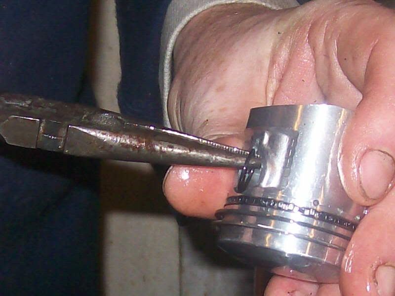

Start with the bottom ring, and work up, BUT in th case of many four strok engins, they hav thre rings, the bottom one an oil control ring, or scraper ring, which is often actually a'compound' ring, as shown.
This has two very THIN and unshapd rings, and a 'wobble' ring or 'mesh' ring between them. Thse can b inordinatly fiddly to get on and in to the piston groove without braking or sticking.
https://i178.photobucket.com/albums/w269/teflons-torque/Little%20Dreams/LD07%20Eng%20Build/104_0250.jpg~original
Rings have to be GENTLY walkd onto the piston and then down the skirt into thir respective groove.
https://i178.photobucket.com/albums/w269/teflons-torque/Little%20Dreams/LD07%20Eng%20Build/104_0252.jpg~original

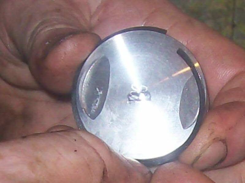

Then, built up, ONE gudgon pin fitted. Note the orintation of th piston; its often marked with an arrow and or 'Front' or in this case 'IN' in th valv pocket machining to align with the inlet valve... so that goes at the back of the engin then!
When you fit the pistons to the con rod, you will slid th gudgon pin in from the outsid, as THAT is th asier side to do it from, and you DONT want th pin coming straight out the othr side of the piston, or struggling to fit circlip to the inside, between all the barrel studs, so fit the INSIDE circlips before fitting to rods.

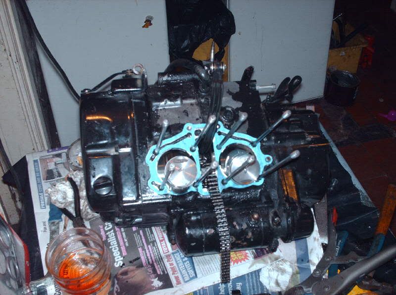

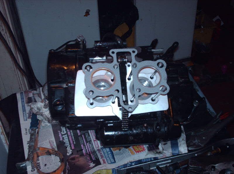

Base gasket and Cylinder head studs replaced, and the barrel fitted on.
https://i178.photobucket.com/albums/w269/teflons-torque/Little%20Dreams/LD07%20Eng%20Build/imag1863.jpg~original
https://i178.photobucket.com/albums/w269/teflons-torque/Little%20Dreams/LD07%20Eng%20Build/imag1864.jpg~original
Head Gasket goes on, and then the cylinder head.
https://i178.photobucket.com/albums/w269/teflons-torque/Little%20Dreams/LD07%20Eng%20Build/imag1865.jpg~original

Recycled photo or 'removing' the cam chain, because I forgot to take one putting it back on! Likewise refitting the cam chain sprocket! ALL after the idgery nadgery job of timing the cam in!
