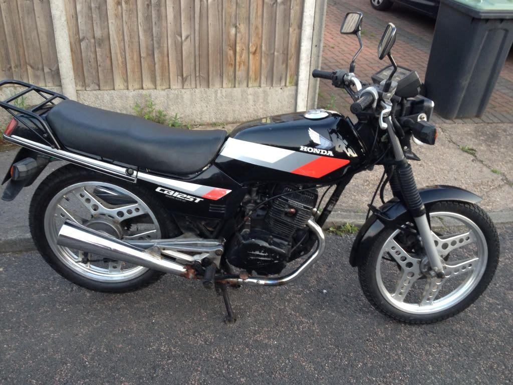

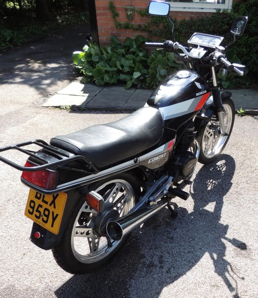

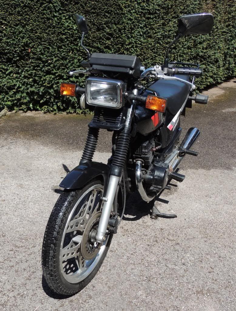

My motorbike is certainly old enough to qualify for a build thread and if I can get hold of some new stickers, it'll look like a restoration job, so I thought I'd start a thread for a record of what I've done.
https://i864.photobucket.com/albums/ab203/Revolverc24/Motorbike/Bike_002_zps092caf40.jpg?t=1371571366
https://i864.photobucket.com/albums/ab203/Revolverc24/Motorbike/7a2657c5302e30a1ffca74cdd81e925a_zpsdd9f703b.jpg?t=1371571372
https://i864.photobucket.com/albums/ab203/Revolverc24/Motorbike/Bike_001_zps9ebec18d.jpg?t=1371571372
These are the pictures from the eBay auction.

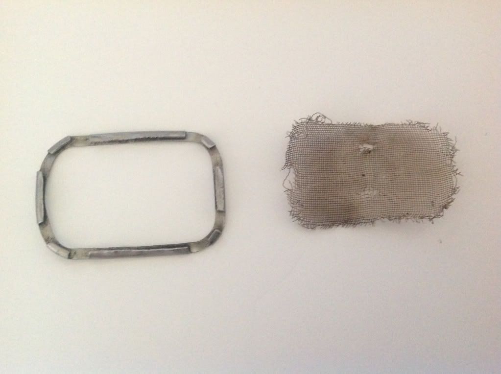

So far I've opened up the rocker cover and checked the CCT and valve clearances, and all was well. I've also opened up the clutch case to get at the oil filter.
https://i864.photobucket.com/albums/ab203/Revolverc24/Motorbike/e92c7ce82a46e2f084f66ec428cc64e1_zpsdef1b30a.jpg?t=1371571431
This is what greeted me. Almost.
Obviously it was in one piece at first! In Teflon Mike's thread there's an excerpt from the Haynes manual saying if there's any holes at all, to replace it. I'd be tempted to leave it as it was if the holes were small but these are pretty significant so out it came.
Nowhere on the internet is a replacement filter for this bike to be found, so I've ordered some wire mesh (grade 40, if you're interested) that matches this so I can cut a piece to size and refit it. The metal frame isn't going to take replacements too many times but I hope I can get away with only needing to do this once.

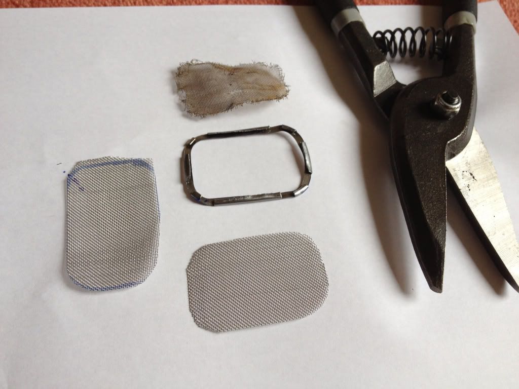

The replacement wire mesh came today. The wire itself looks to be ever so slightly thicker. I don't think this will be too much of an issue but I suppose we'll find out, lol. It's a hell of a lot sturdier than the old stuff which means it shouldn't get torn by anything.
I suppose if I keep on top of keeping it clean there won't be any issues.
https://i864.photobucket.com/albums/ab203/Revolverc24/Motorbike/bee186390b7c31a905dd6bfd63d88558_zpsf96a2796.jpg?t=1371641380

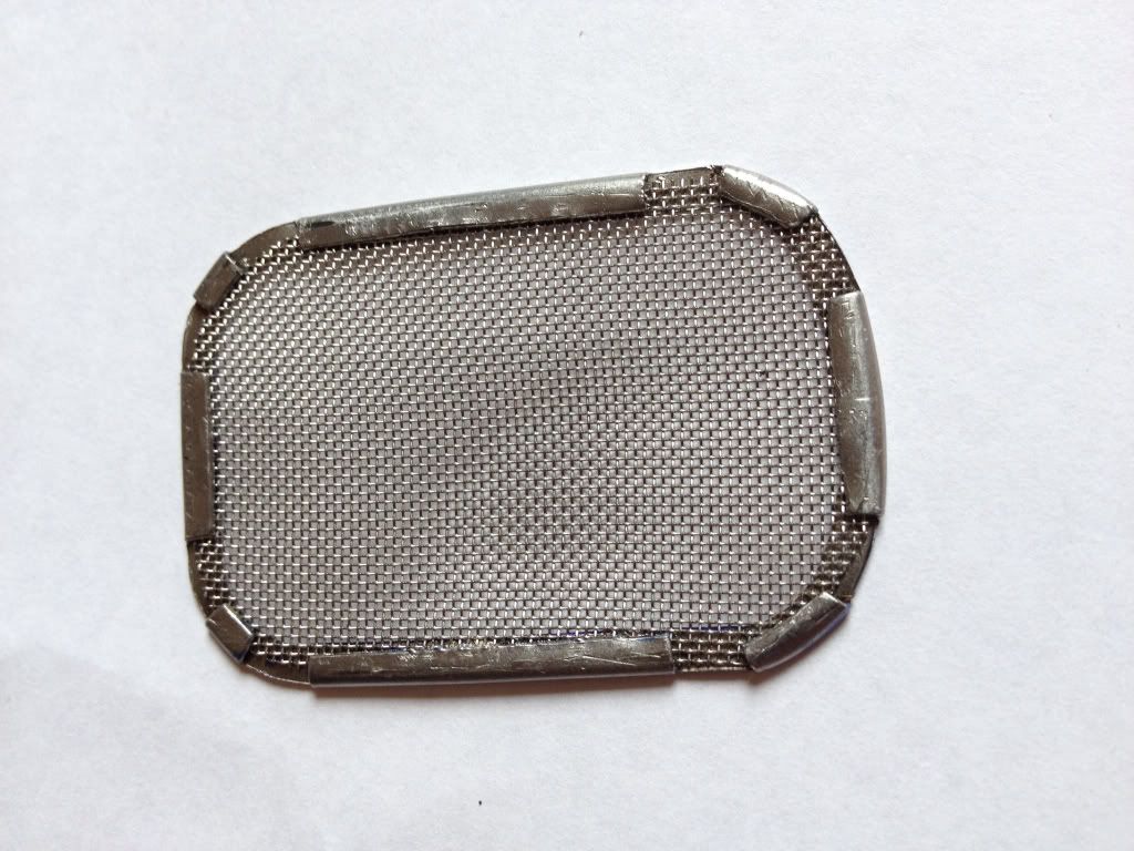

I had a couple of attempts first getting the size dead on. Your best bet is to cut the new filter down to the outside of the frame and then shave a millimetre off at a time so that it fits.
https://i864.photobucket.com/albums/ab203/Revolverc24/Motorbike/a25568d55b150ac30ea474f5ce4e9267_zps884b762b.jpg?t=1371641410
Finished product, ready to go on.
I'm going to have some dinner and then cram this filter back where it goes and fill it up with oil and start it up again.
