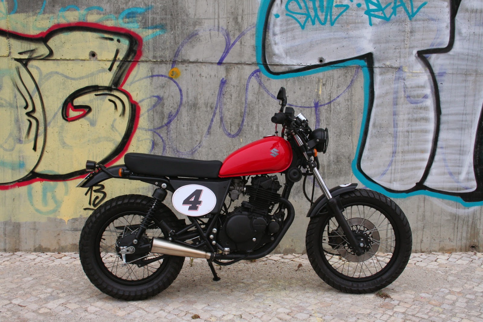

A portugese has done a rather nice job on his:
https://motrizadas.blogspot.co.uk/2013/05/project-gn-250-by-paulo-gomes.html
https://4.bp.blogspot.com/-1JxWJrkjHig/UznBgD9wExI/AAAAAAAAAlw/nnbxnksmqHE/s1600/IMG_1548.JPG
Remove all the cruiserness!! Cool

Haha that portugese bike looks just like a couple of my old ones but with a bigger budget.
they have done the same trick and reused the rear mudguard mounted higher and looks like a cut down standard pipe too (I wouldn't recomend it it will run like shit and be loud as fuck)

that Portuguese one looks like it has longer rear shocks on it, as well as moving the rear mudguard.
can you not use the seat base you have and just custom cut some foam?
