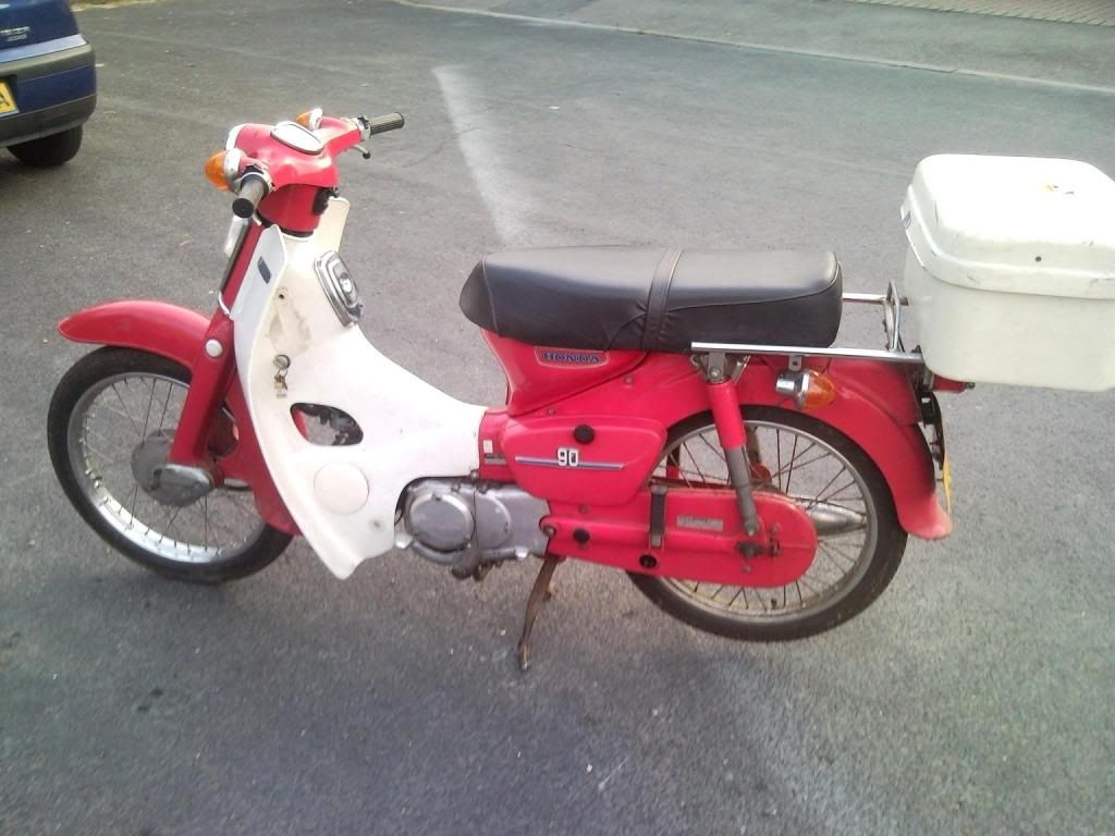

Don't ask me why I started looking at this style of bike or why even started bidding but just fancied something to strip down and rebuild as something to do.
I still have no idea as to the final result I'm after and to the extent that I'm willing to go for a bike that is yet to be tested or even aware of anything on it actually works, but it's all a learning curve right?
So after splashing £200 for a local bike that had sat for 16 years in a garage and never seen in the flesh and little information I was the winning bidder. The. seller even offered to deliver it to me at no charge. How nice is that?
https://p1.bikepics.com/2014/03/27/bikepics-2654994-full.jpg
A bike for the whole family
