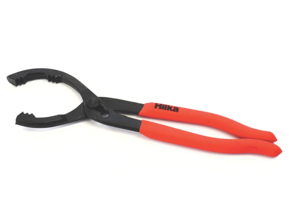

https://s7g3.scene7.com/is/image//ae235?src=ae235/34733_P&$prodImageMedium$
I use a pair of these £12 jobbies from Screwfix, purely because access to the filter on the GSX1250 is tight behind the downpipes and I can't get my fat hands in there.
On anything else with easy access you should be able to just spin it off by hand. They go on hand tight (20 Nm at most) with a nice smear of oil on the o-ring so shouldn't really need the nut anyway.

I have several oil filter removal tools, none of which will reach up inside the recessed bowels of my bike to successfully remove the filter. I could buy the specific filter cup, but I've had one of those slip before as well. I also have one of those three pronged cog tightening ones that just crushed a filter in place.
I always fit filters hand tight with a smear of oil, but over time and heat cycles they seem to get tighter.
