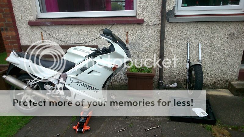

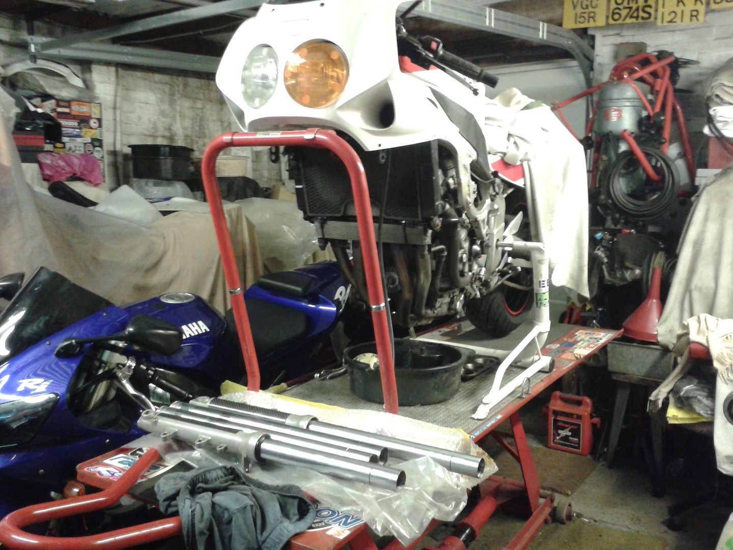

Have you not got access to a front stand?
https://i666.photobucket.com/albums/vv23/WiNot_Rhencullen/Workshop/20160906_192026_zpsg7qypztn.jpg~original

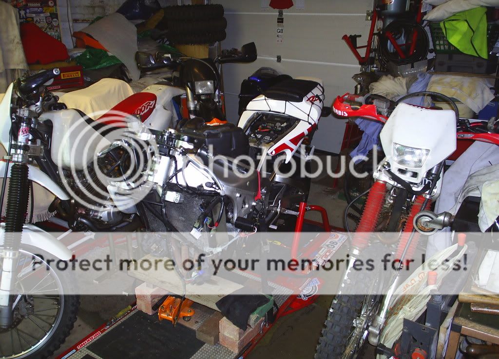

In the past I have used a block of wood under the engine together with a car jack and once up to the right height I placed some bricks under each side of the length of wood.Messy but it worked while I had the front end out of a R1

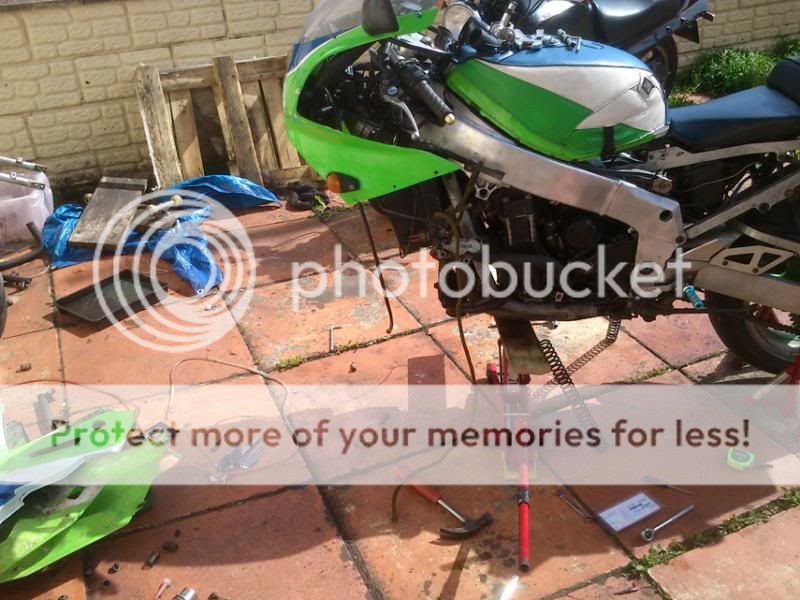

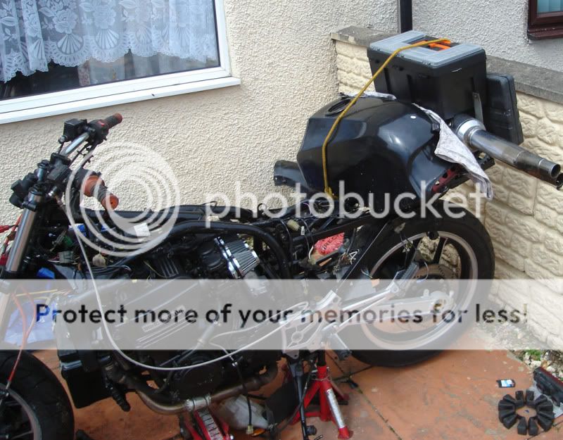

I've never had a problem with side stand (or axle stands) and trolley jack and loading up the back of the bike (GPz sat on the trolley jack for 6 or so weeks without any problems, VFR sat overnight like that):
https://img.photobucket.com/albums/v320/andy36586/GPz750/balanced2.jpg~original
https://img.photobucket.com/albums/v320/andy36586/VFR/VFR_zpscccvvbg0.jpg~original
https://img.photobucket.com/albums/v320/andy36586/forksremoved_zps635ade0e.jpg~original
Also done the same with the ninja and CBR when replacing tyres
Depending on which end I'm working on I'll either jack it up on the sump or downpipes.... only problem I've found is as the bikes have got heavier, the more stuff I've had to dump on the back seat to tip the balance.
