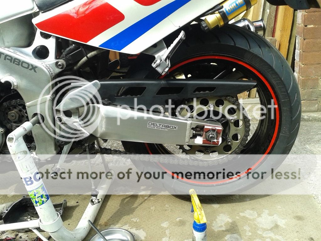

On my FZR-R I use 'R' clips together with a small zip tye
https://i666.photobucket.com/albums/vv23/WiNot_Rhencullen/Workshop/20150730_153901_zpsq5fqw91b.jpg~original

That's a really clear picture, thank you. I think mine goes through the screw threads from memory, I'll have a look and take a pic if it's different to yours and see what you think.
