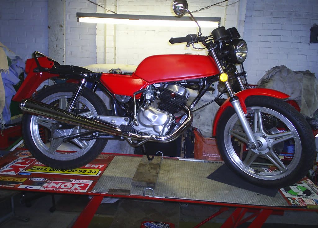

I own a CB125-T2 that I have been doing up as a project for quite a few years now Thumbs Up
https://i666.photobucket.com/albums/vv23/WiNot_Rhencullen/CB125T2/Picture387.jpg~original
Unfortunately the pistons and valve guides are so worn that I ended up buying a pattern set of barrel and pistons,with the intention of finishing off the project.But that was before I became a grandad and much of my spare time is helping my daughter do up her house
https://i666.photobucket.com/albums/vv23/WiNot_Rhencullen/CB125T2/2013-03-19151443_zps3389c7cf.jpg~original
The camshaft,followers and bearings are all good so if you need any dimensions while the engine is in bits,then just ask Thumbs Up Wink

PostPosted: 16:55 - 17 Apr 2019    Post subject: CB125T up and running Reply with quote
Finally got my CB125T on the road today.
I had the cam reprofiled to what I thought were the "desirable" hot cam timings, and it wants to rev but no more than about 10k. I have open carbs, I couldn't find any inlet connection hoses or air filters.
So to compensate I am thinking I should increase the main jet size. The other factor is the 142 cc conversion. The exhaust have been cut open and the inner down pipe removed.
From various websites I have found that the standard main jet size is 88. I would go up to 100 with my mods.
Has anyone tried this, or have any recommendations?
I think I'm going to be busy trying to sort the front brake too....
