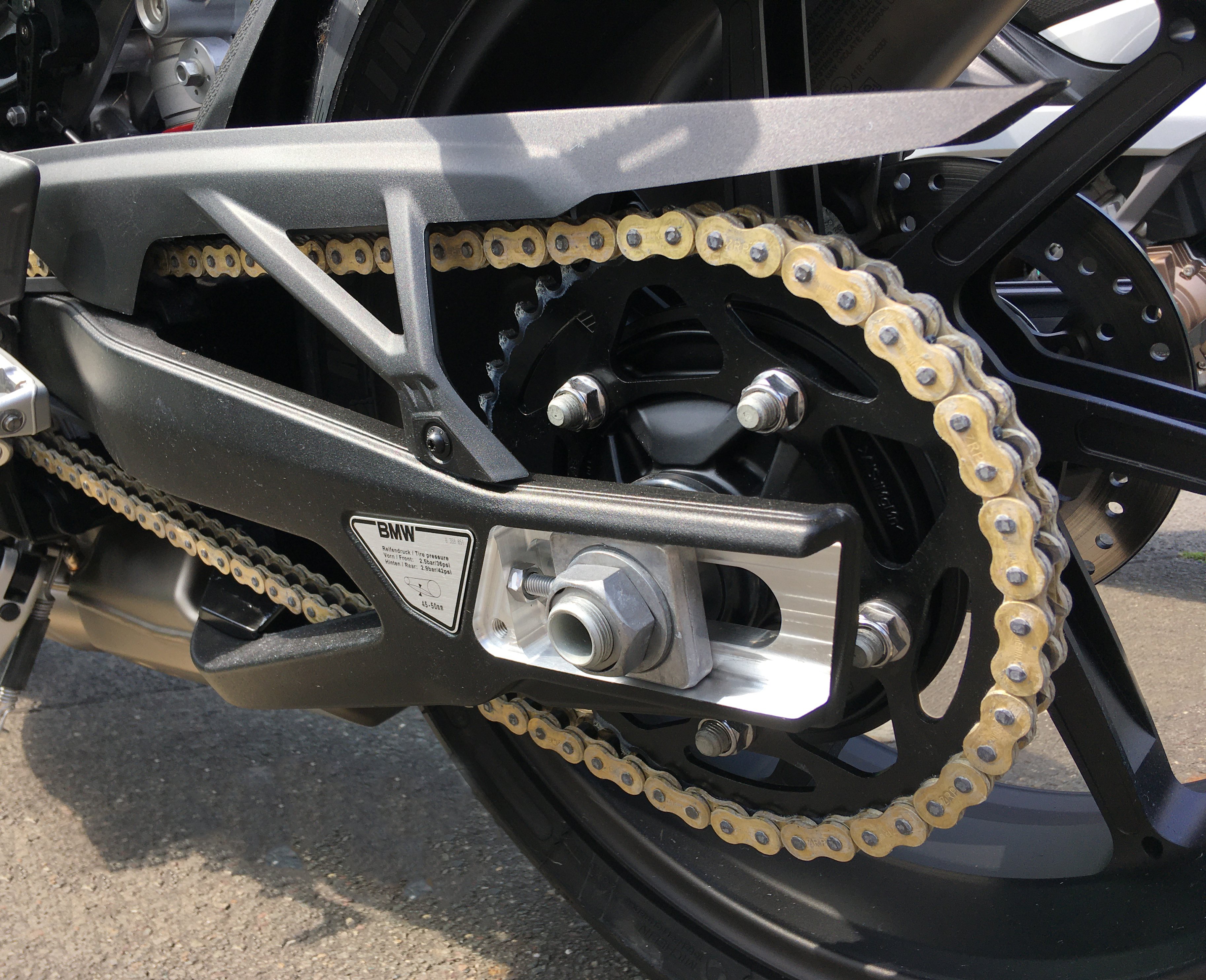

PostPosted: 13:21 - 28 Aug 2020    Post subject: Maintenance free chain? BMW say yes. Reply with quote
https://pbs.twimg.com/media/EggOnfHUwAEgFTc?format=jpg&name=4096x4096
https://pbs.twimg.com/media/EggOnfLVgAUJ2hy?format=jpg&name=4096x4096
BMW say they've built a chain you never have to lube or adjust thanks to some new whizzy-coated rollers. It's optional on the S1000RR & XR.
Costs £100
https://www.bmwmoa.org/news/523555/BMW-Motorrad-announces-maintenance-free-motorcycle-chain.htm

So if it is relying on the component coatings, what are the seals for?

An interesting idea.
Why does it need any "resident permanent lubricant" at all for the rollers and pins enclosed by X-rings, though, if the "ta-C" coating does not wear, and is so friction-free, I wonder? Come to that, why does it need X rings at all?
What are the sprockets made of?
Interesting, and I'm sure someone will be testing IRL before long.

It does say in the article that is has a lubricant but I suppose the coated rollers just reduce wear.
A lot of articles are calling it lubricant free, which obviously isn't true. I suppose most people dont realise the oil they put on their o ring chain is for rust prevention, not really lubricating anything. With all the coatings, this wouldn't need it.
"having to spray cleaners and lubricants on a chain means a smaller environmental footprint, something BMW touches on in their press release as well."

I always thought what wears out o-ring chains it's the sprocket/roller interface that wears.
That's where you direct the oil with a scotoiler and I know they massively increase chain and sprocket life.

The O/X-seals on this and existing chains keep assembly oil between pin and roller. The innovation here is the coating on the rollers which contact the sprockets.
a new coating... which they call tetrahedrally amorphous carbon (ta-C)... is characterized by extreme hardness and resistance... BMW further states the ta-C coating drastically reduces friction...
Still, it's four times the price of a normal chain... Thinking
