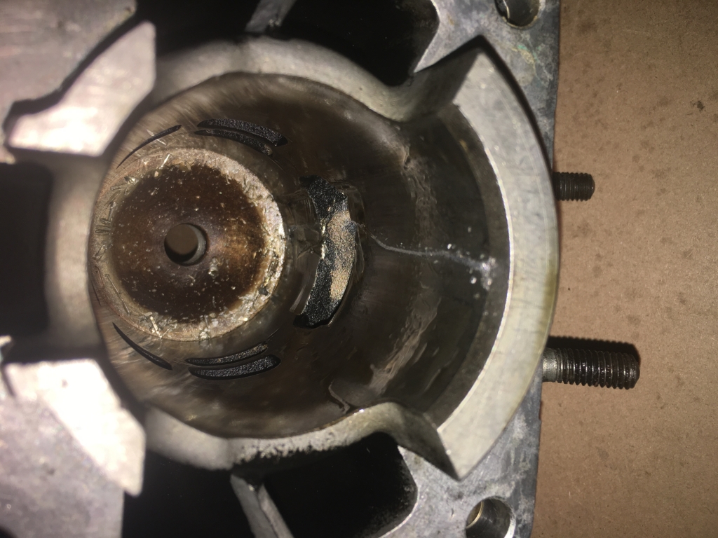

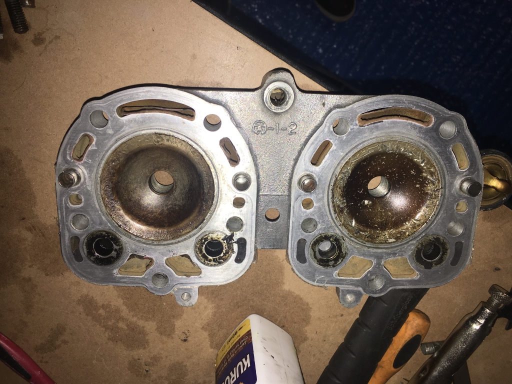

As some of you know I've had a KR1S languishing at the back of my garage for a number of years. I bought it in about 2013 and it was apparently rebuilt from NOS parts. The seller told me the pistons were the new pattern which didn't have the fatal flaw with the ring pegs...
I didn't ride it a lot, but I did ride it occasionally until 2017 when I couldn't get it to run any more. I spent a load of time taking the carbs off and making adjustments. I replaced the fuel tap thinking the issue was fuel starvation. It would run sometimes but not very well. So I trailered it over to a local dyno place to get them to have a look. The news was not good. They had put an endoscope in the exhaust port and found internal damage. The ring pegs had made a bid for freedom!
The damage was... not good.
https://www.bikechatforums.com/files/img_4751.jpg
https://www.bikechatforums.com/files/img_4744.jpg

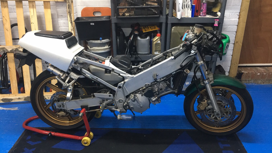

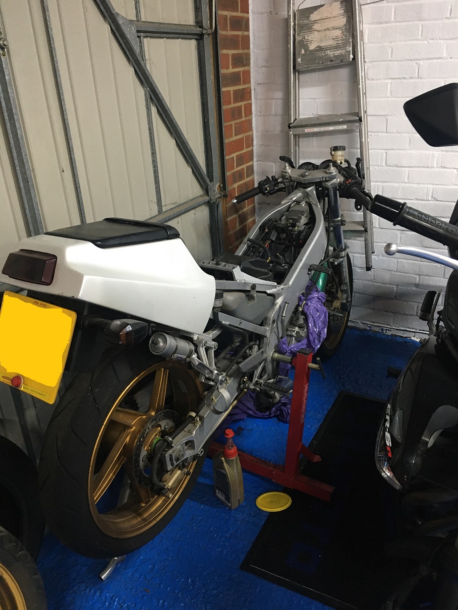

In 2020 during lockdown I managed to strip the top end of the bike and get it ready for a rebuild. The bike then stood in my garage looking sorry for itself with a plastic bin bag over the open crankase like a rag covering a persons modesty. It really did look a state.
https://www.bikechatforums.com/files/kr1s-1.jpg

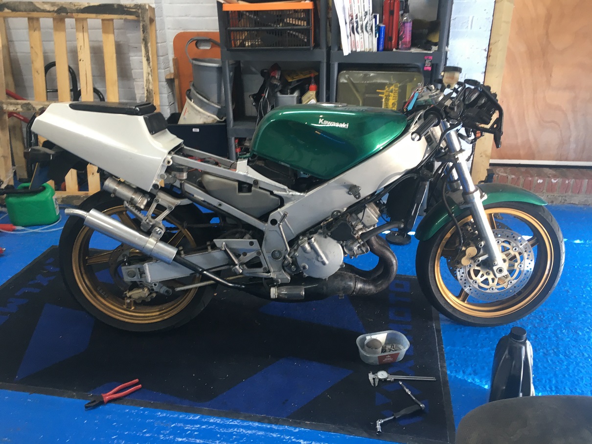

Fast forward to the end of June where I put the pistons and barrels back on the bike, and then to the weekend before last where I got it to here:
https://www.bikechatforums.com/files/kr1s-2.jpg

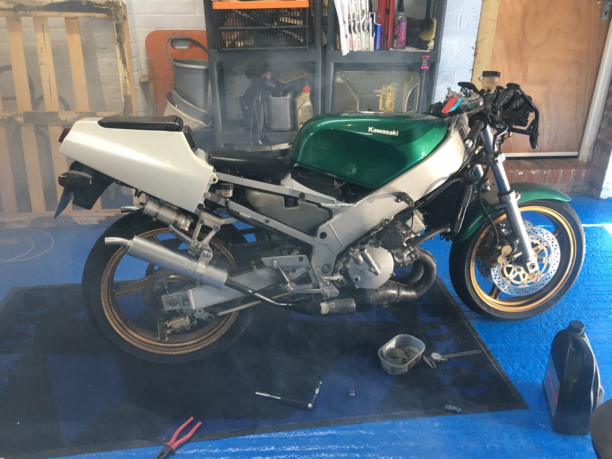

Then, after a few kicks and a lot of sweat (it was extremely hot yesterday) I got to here:
https://www.bikechatforums.com/files/kr1s-4.jpg
and then, realising my new garage has terrible ventilation, I did this:
https://www.youtube.com/watch?v=o5F61HZ9oNc
The idle is extremely high, so I need to look into that, but otherwise I'm very pleased. I had no idea of the carbs had solidified in that time with old petrol etc, and once it was going, it was a matter of one kick to get it to re-start.

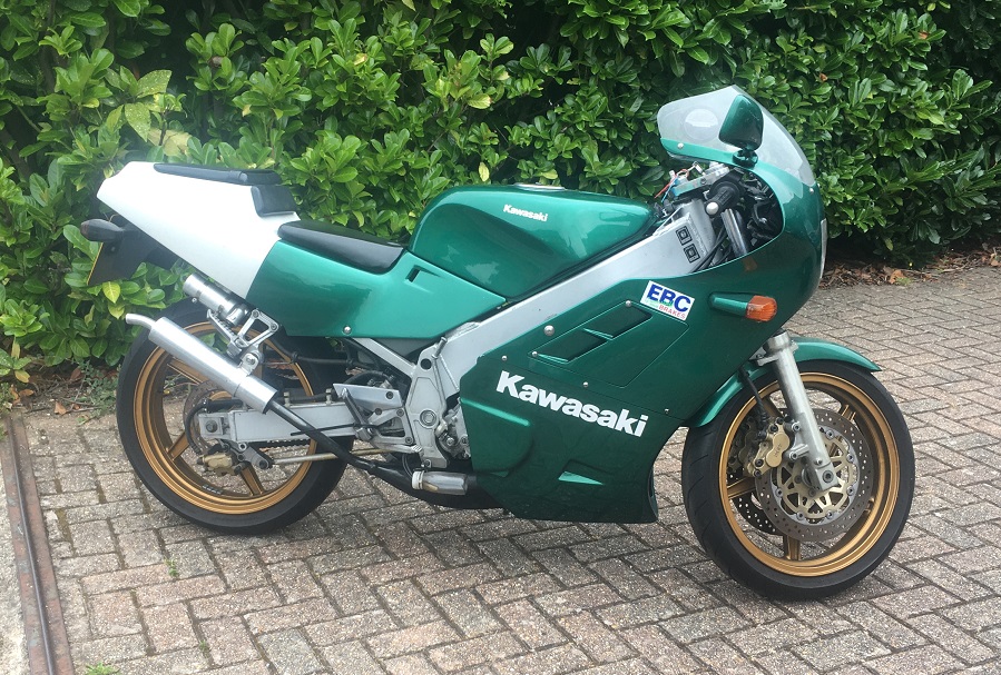

So I then spent most of the afternoon putting it's clothes back on:
https://www.bikechatforums.com/files/kr1-s_nearly_done.jpg
I found that the brand new 8mm fuel pipe I fitted before it stopped working has all cracked and is now leaking, so I'll need to replace that, but the brakes work, the indicators work, the suspension seems OK, it seems to start easily and run OK so I think it's not far off having an MOT. The first time in four years! Smile
