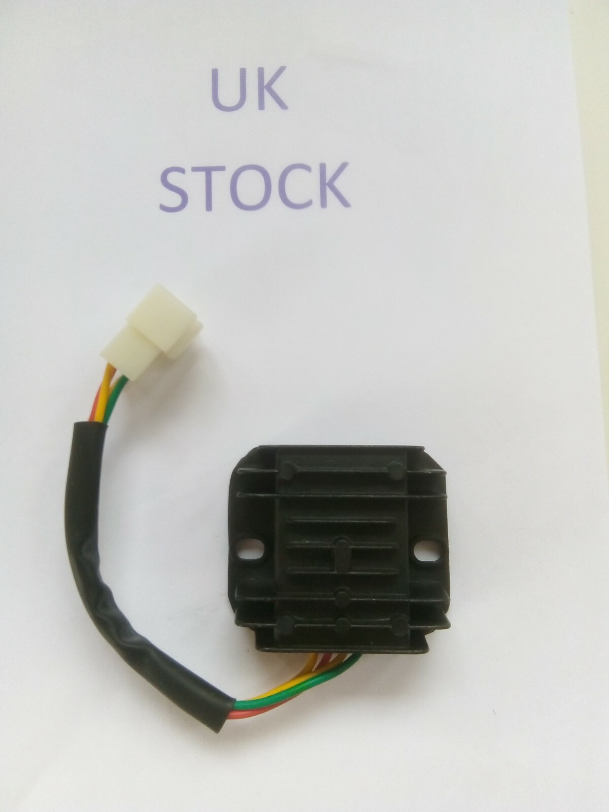

PostPosted: 16:45 - 30 Jul 2021    Post subject: Reply with quote
Its probably a project that needs some experimenting
and woudl love to put my scope on it but
my initial thoughts on a single phase setup would be to
wind all the bobbin in the same direction as in your proposed setup pic
This cos as the coils are at 90 degree intervals and the rotor has 8 ( or 4)
magnets, all windings will be swept by the same N or S pole at the same time
Make sure to sleeve and insulate the wire from the engine body(ground) and run both
tails to something like this which I assume/hope has a full wave bridge rectifier inside
as well as voltage regulation
https://i.ebayimg.com/images/g/~EwAAOSw5W9e62Zp/s-l1600.jpg
https://www.ebay.co.uk/itm/313119747851?hash=item48e7642f0b:g:~EwAAOSw5W9e62Zp
On the output as well as a big cap, I'd add a smaller secondary cap for extra ripple smoothing
as leds tend to react a lot more to voltage variations than an incandescent blub.
I'd consider using a weeny scooter battery if voltages allow as this can help smooth out voltages
I can only guess but comparing it to similar setups I reckon you may get say 70-80 watts/6A-ish out of it
which is enough to run a 20w headlight which will be fookin bright!
Be wary when buying led headlamps as I've seen many sellers state the equivalent power rather then actual which can be misleading
and say its 100W when in reality it uses 20W of real power
